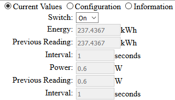

The only problem I have right now (2x multisensors working fine) is that the greenwave powernode 1 port reports the electric usage twice in watts. I would expect one device to show up as electric, KWH or similar. Instead i have two devices that reports exactly the same thing. I have tried to exclude/include the device several times, but no change.
Also, in the openzwave control panel the values are reported properly, one for watt usage, one for kwh usage.

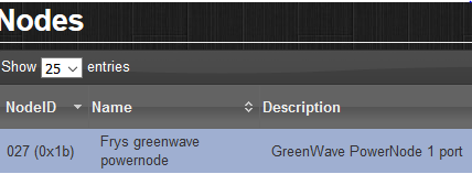

I am attaching 3 screenshots from the hardware tab, device list and the openzwave control panel for further info on what I am seeing.
