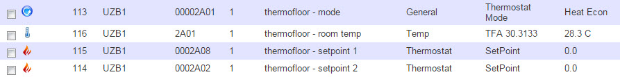

Thats how I tested the settings.
I haven't installed mine yet, so I haven't done anything with them since I made the xml, but I agree. Its not working satisfactory quit yet.
I added this to the xml.
<CommandClass id="49" name="COMMAND_CLASS_SENSOR_MULTILEVEL">
</CommandClass>
I then get these devices
thermofloor devices.jpg (41.08 KiB) Viewed 9336 times

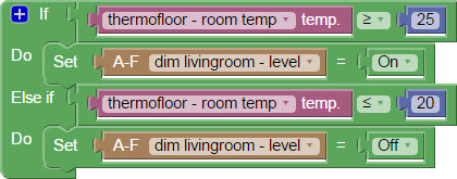

With room temperature from the heatit, I can turn a light on and off using blockly
thermofloor Blockly.jpg (39.77 KiB) Viewed 9336 times

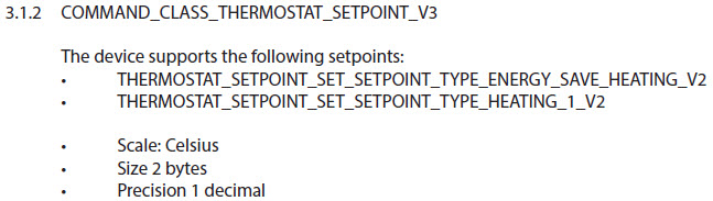

@rtulp, I see that you have command classes within command classes. Is this possible? I havnt tried your settings yet, but I see you have quite a few more command classes added than I have. I have included/excluded the device a number of times now, but the only additional command class that works for me, is the "49, multilevel". If I try and add any other, something breaks, and I loose one of the devices. Below I have added what currently gives me the two setpoints (which dont work), selection mode (can be changed in the device, but not with blockly), and room temerature (works with blockly).
Looking in the engineering specification for the device, there is the command_class_thermostat_setpoint_v3, which is currently not supported in ozw. Perhaps if this was supported in ozw, the setpoint would work in domoticz?
thermofloor command class.jpg (47.76 KiB) Viewed 9312 times

3.1 Supported command classes
The thermostat implements the following command classes:
• COMMAND_CLASS_BASIC
• COMMAND_CLASS_ZWAVEPLUS_INFO_V2
• COMMAND_CLASS_THERMOSTAT_SETPOINT_V3
• COMMAND_CLASS_SENSOR_MULTILEVEL
• COMMAND_CLASS_VERSION
• COMMAND_CLASS_THERMOSTAT_MODE
• COMMAND_CLASS_ASSOCIATION_GRP_INFO
• COMMAND_CLASS_POWERLEVEL
• COMMAND_CLASS_MANUFACTURER_SPECIFIC
• COMMAND_CLASS_DEVICE_RESET_LOCALLY
3.1.1 COMMAND_CLASS_BASIC
The thermostat will change the operating mode when it receives BASIC_SET:
• BASIC_SET value 0x00: Thermostat enters Energy saving heat mode (ECO)
• BASIC_SET value 0xFF: Thermostat enters Heat mode (CO)
With BASIC_GET, the device reports its state with BASIC_REPORT using the same values as above.
3.1.2 COMMAND_CLASS_THERMOSTAT_SETPOINT_V3
The device supports the following setpoints:
• THERMOSTAT_SETPOINT_SET_SETPOINT_TYPE_ENERGY_SAVE_HEATING_V2
• THERMOSTAT_SETPOINT_SET_SETPOINT_TYPE_HEATING_1_V2
• Scale: Celsius
• Size: 2 bytes
• Precision: 1 decimal
3.1.3 COMMAND_CLASS_SENSOR_MULTILEVEL
Thermostat implements room air temperature sensor functionality. The sensor always measures
the room temperature no matter what the operating mode is set to.
• Sensor type: Air temperature 0x01
• Scale: Celsius 0x00
• Size: 2 bytes
3.1.4 COMMAND_CLASS_THERMOSTAT_MODE
The following modes are supported
• OFF 0x00
• HEAT 0x01
• ENERGY 0x0B
3.1.5 COMMAND_CLASS_ASSOCIATION
• Association group 1: Lifeline. All run-time reporting is addressed to this group. Max.
nodes: 1.
• Association group 2: On/off control. This controls external heaters replicating the
state of the internal relay. Uses BASIC_SET command, values 0x00 (off) and 0xFF (on).
Max. nodes: 8.
3.1.6 COMMAND_CLASS_MANUFACTURER_SPECIFIC
• Manufacturer ID: 0x019B
• Product ID: 0x0001
• Product type: 0x0001

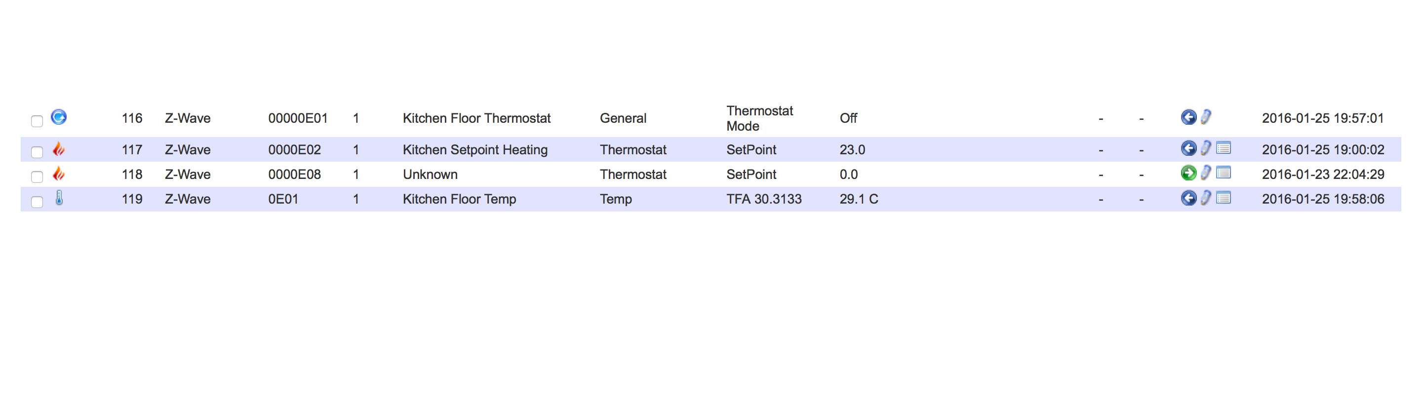

rtulp wrote:
alexsh1 wrote:I have two Setpoints - one I cannot change but the other one is changing the heating temp
And was it automatically in Domoticz? I can't find a setpoint which is working. Neither a way to automate the HeatIT with blocky
I can change the temperature in the settings of the device if I click on Settings ==> Hardware ==> select Z-wave ==> Settings ==> Select the Heat IT
Yes, it was automatic with the XML file in post 19, basically, I have had four new IDs added automatically:
- Thermostat mode
- Setpoint
- Setpoint
- Temperature

cogliostrio wrote: @alexsh1
Could you post which setpoint works for you regarding changing heating temperature?
@cogliostrio
Please see attached! I understand that the one marked unknown is for cooling.
I use the one marked for kitchen. In the attachment the thermostat is set for 23C in the evening (after 19:00)
Both of my thermostats work in the same manner.
