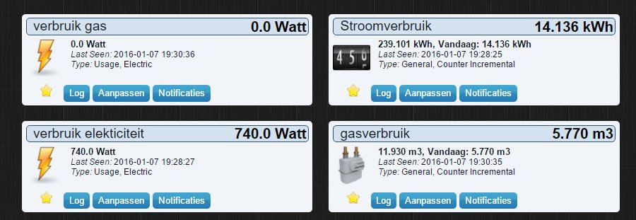

power counters used for Gas
domoticz counters.jpg (59.8 KiB) Viewed 1945 times

1) How is Domoticz calculating the pulses to KWH and M3 Values?
2) For the poweruse I have 2 items, 1 gives the use every 5 minutes and another once the hour. This gives me the option to find peaks in the powerconsuption.
For the use of the gas there is no such option. The gas use is shown once per hour. And I made an extra Powerusage. Is there a way to change the units from Watt to m3 with right calculation?
In the image stoomverbruik and gasverbruik are the items for once per hour.
The verbruik gas (used gas) is the item I would like to change.
kind regards
Har

Do If I understand you correctly the counter that states "verbruik gas" with 0.0 Watt behind it is a esp8266 pulse punter.
You should be able by selecting Aanpassen to change from electric consumption to gas consumption or water consumption what ever is needed.
