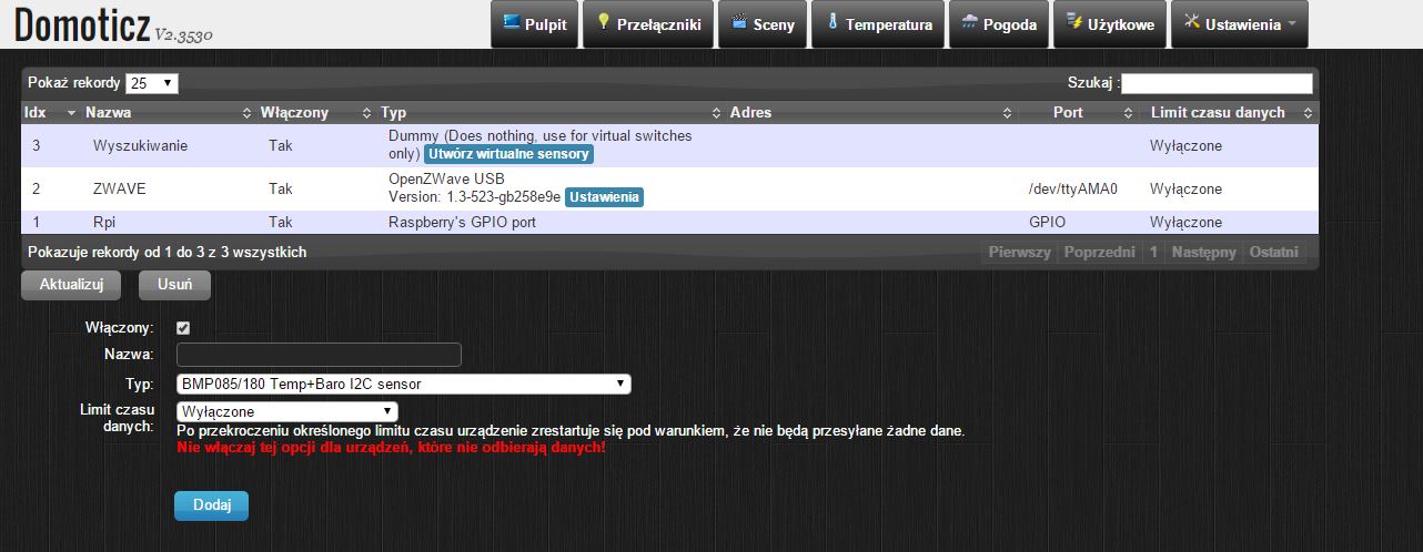

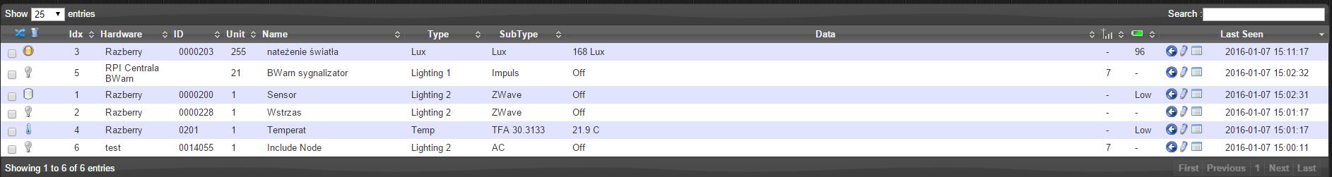

I heve one question.
After reset my RPI with Razzbery i lost all devices / all node.
Now i must log into web --- > hardware ---> Include node ...
I thing about new solutions.

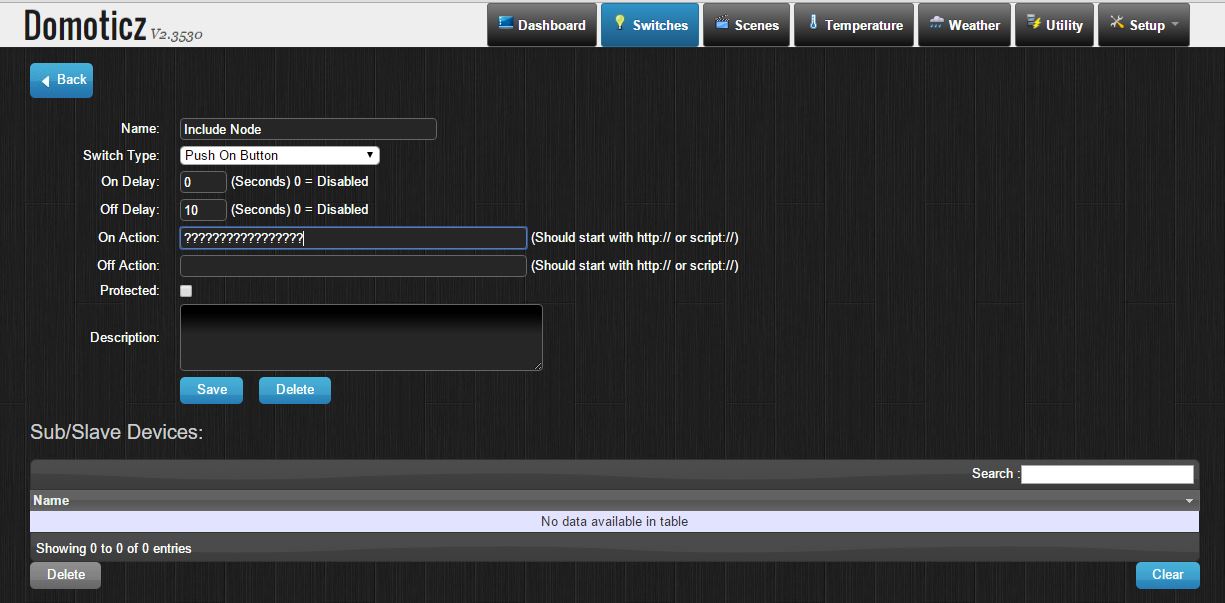

I make new virtual switch
I will push this button and start including node but i don`t know What should I enter in field "on Action"
Please help me
sorry for my English
bbqkees
Posts: 407
Domoticz version: 4.1x
Re: Best way to include z-wave devices?
Post by bbqkees »
Go to hardware->your Zwave controller->Setup->Node Management->Include node.
Also press the include button on the node.
Keep in mind the distance between the controller and the node should be within 30cm.
if it includes correcly, the node will get a number.
Next go to Settings->Devices and create new devices in Domoticz from the ones you just got from the ZWave inclusion
azzurek
Joined: Wednesday 06 January 2016 17:05
Post by azzurek »
Thanks for Your answer.
I know how to add device.
Now all be gut

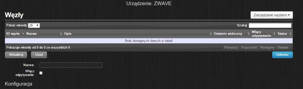

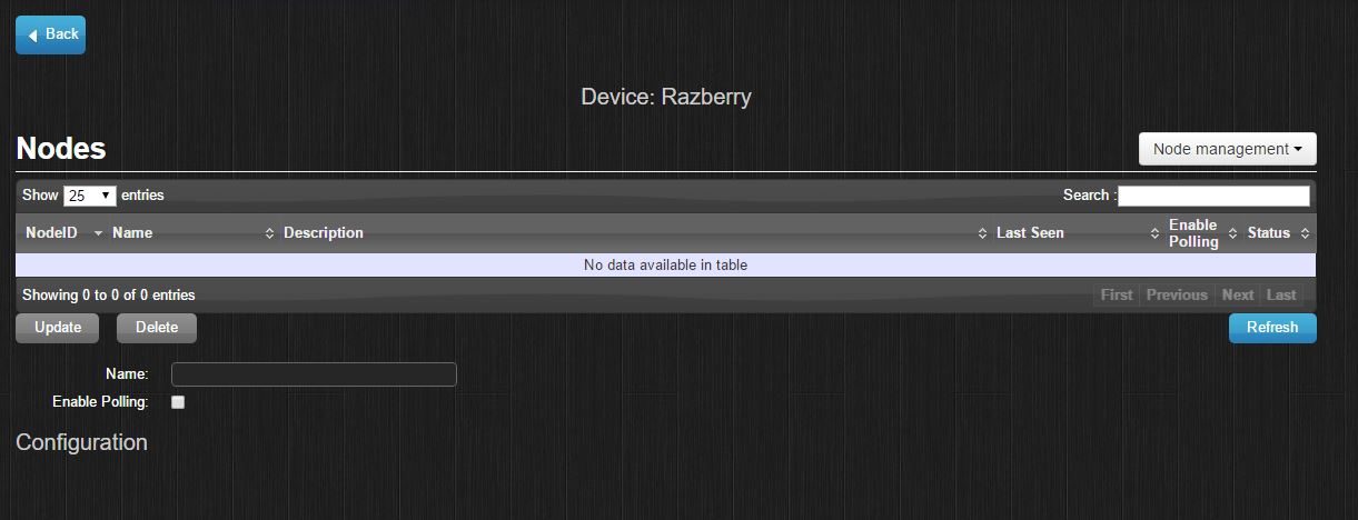

But if I turn off Raspberry and after 15 min I turn it on , I lost all node.
I see device in control panel but i don`t see node :
I must again enter into hardware --> setup --> node menagment --> Include node.
if I had a router failure how i can Include node ?
Isearch another solutions e.g launching the process Include node by the physical button connected to GPIO in RPi.
e.g If Button is on --> turn on Include node process
it`s that possible?

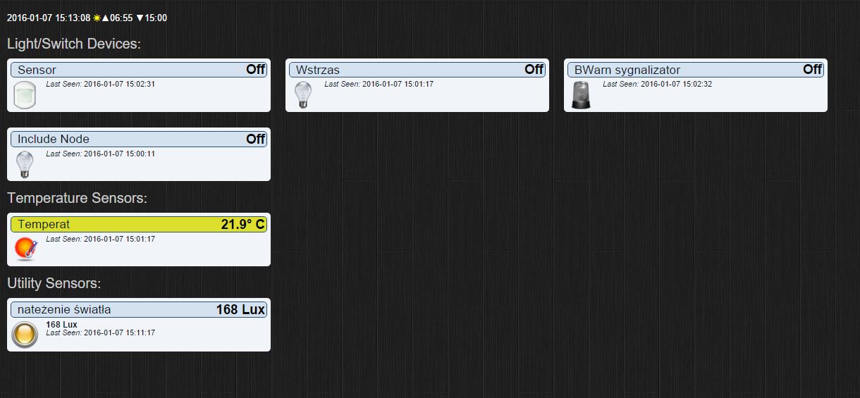

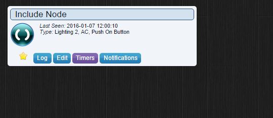

i heve one question.
maybe can I includ z-wave nodes with API?
Could someone give me API code to start z-wave including nodes :( ?
azzurek
Post by azzurek »
I heve solutions !! :)
Just : (..)/json.htm?type=command&param=zwaveinclude&idx=xx

I still have a problem with Node`s so please help me.
Describe the problem step by step.
System:
Raspberry Pi B+
Domoticz
RaZberry (Z-wave)
Fibaro Multisensor [powered by a battery]
1. Connect the power supply to RPI
2. I log into the control panel Domoticz -->settings -->hardware and i see my OpenZWave
3. In setting OpenZWave USB i see any node:
4. Now i click Include node and after that i push 3x B-stick in my Fibaro motion sensor
5. Now everything is ok - I see FIbaro and I set WakeUp interval : 200
6 In my devices i See all Fibaro motion sensor: temp, lux, motion sensor ..
7. Now I disconnect power supply from RPi... and after 1 min again I connet the power to the RPi
8. After Reboot i`m wait 5-10-15 min and i log into the control panel Domoticz -->setting -->hardware
See what I see:
the system does not see the device Fibaro.. and i must again log into setting -->hardware -->OpenZWave setting --> include node --> push 3x B-button on Fibaro Multi sensor...
How do I make Fibaro is connected to a Raspberry automatically after reset..
On desktop :
On Domoticz -->setting -->hardware --> :
