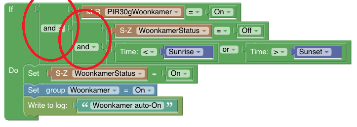

Where can i Find this "and" block that is connected to 1 block on left and 2 at the right?
(image from google):

Right click on the block and select "External Inputs". This will change the block shape to the one in red circles.

now, why is this a usefull thing to do? just to make the code easy to read or can i do somthing more with this "new end"?

As far as I know it's exactly the same, just makes certain layouts easier to read.
I use a combination of both.

It comes in handy when you have several booleans nested.... event A AND event B AND event C AND event D
Your line become quite long.
