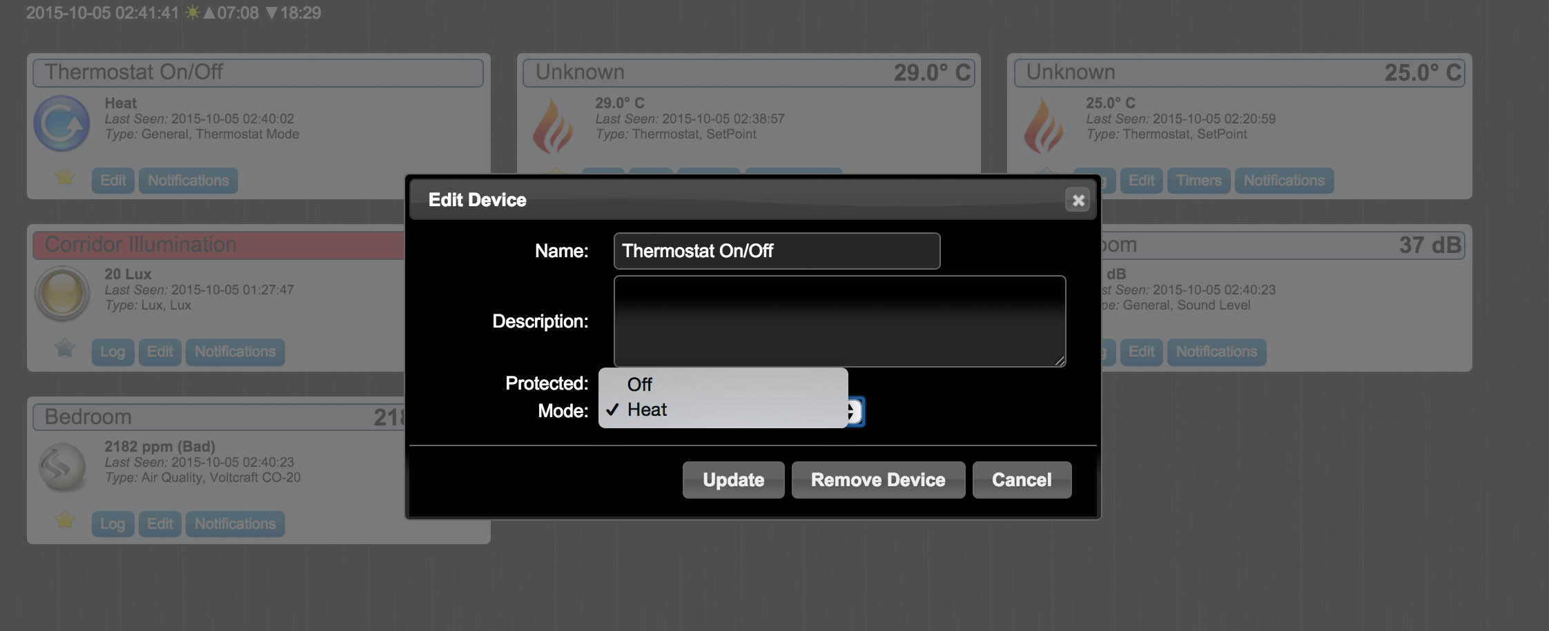

Hello
Did anyone manage to setup Heatit Z-wave theormostat. It is not in the DB of known device for OZW, but the problem is that it does not work.
I have "heating" under devices, but cannot switch it on/off or set the temperature.

Thanks for your feedback Domosapiens. Firstly, the Manufacturers ID has not been recognised by OZW so I had to add it manually to the manufacturer specific xml as follows:
<Manufacturer id="019b" name="Thermo-Floor (Heatit)">
<Product type="0001" id="0001" name="Underfloor Thermostat" />
Apologies, but when you say " without a manufacturer specific file?", you mean without adding extra lines in the file?
I have tried the following:
- Tried thermostat without adding anything to the manufacturer's file - no luck
- Added the above two lines firstly without config="thermofloor/heatit.xml" - no luck
- Added the above two lines as with config="thermofloor/heatit.xml' and currently in the process of looking for the right config in heatit.xml
As I am new to Domoticz, I have been doing some research and thanks for your heads up on OpenHAB vs Domoticz format, I have come up with the following heatit.xml settings so far (work in progress):
/home/pi/domoticz/Config/thermofloor/heatit.xml   [-M--] 37 L:[  1+15  16/ 18] *(465 / 477b) 0010 0x00A
<?xml version="1.0" encoding="utf-8" ?>
<Product>
<------>    <CommandClass id="49" name="COMMAND_CLASS_SENSOR_MULTILEVEL" />
<------>    <CommandClass id="64" name="COMMAND_CLASS_THERMOSTAT_MODE" version="3">
<------><------><value type="list" label="Command" units="">
<------><------>    <item labal="Off"" value="0" />
<------><------>    <item label="Heat" value="1" />
<------><------>    <item label="Energy" value="11" />
<------><------> </value>
<------>    </CommndClass>
<------>    <CommandClass id="67" base="0" />
<------>    <CommandClass id="133" />
</Product>
Again so far no luck - I cannot control the thermostat properly from Domoticz
And I have "(Z-Stick) Thermostat (Unknown)" in my log file.

I manage to get the following, but this is far from being ideal.
Problem: I cannot control the heating from Pilot App on my iPhone. Neither can I adjust the temperature.
Another problem I discovered was that if I run domoticz with -verbose = 1, I have more settings under Mode (Off, Heat, Economy) (the second picture above).
I think this is a bug in beta 3219.

Hello Gijs,
It is functioning - I can turn it on/off remotely, set the temp and monitor the temp, but there are a couple of issues.
1. You cannot control it from your iPhone through Pilot App.
2. You cannot set timers (see my photo above)
The same product is functioning well under Veera so I think OWZ is going to be corrected for this one shortly.
Currently, this is the only one product on the market so the choice is either Heatit or Heatit :)

Only thing what I can change is the mode, between Eco, Heat and OFF. What to do to change the temp in Domoticz?

I have two Setpoints - one I cannot change but the other one is changing the heating temp
