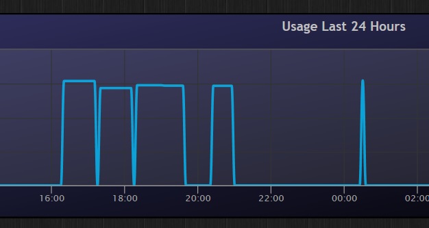

i have noticed that the power usage is not functioning like it should.
i have a Fibaro FGD212 dimmer which functions well
now for the power usage it seems that from time to time the power usage goes to 0 while the light actually is still on.
when you check devices you clearly see the power device using apprix 78 watts and Kwh device is showing a value.
back to the utility tab it shows 0 watt and the Kwh is not running.
anybody has any idea where to look to solve this.
Device showing
80 watt
2 Kwh
utility tab showing
0 watt
2Kwh(and meterr is not advancing)
domoticz version 2.4020 (jumbotroll version)
i can not downgrade to a stable sversion to see if this solves the issue
utility tab showing
0 watt
2Kwh

did some further testing.
de fibaro wall plug functions like it should with reporting enabled
with the fgd-212 Domoticz sometimes switches powervalues on/off after a generated report
the only way to get the fgd-212 report the normal power levels is:
turn of al the reports
turn polling on on the device
