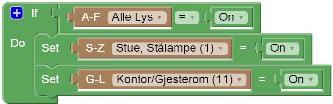

Hi.
I'm trying to make a dummy switch that turns on two off the other lights.
But it don't seem to works.
the dummy is set to "on", but the other lights don't turn on.

I think you have used the wrong If block. As you do not have an Else If, try using the block without the "+".

your right :) works now
