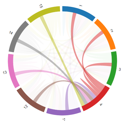

Yes, it will connect itself to other nodes, but if you hover with your mouse on a Greenwave plug, you will only see lines of that plug going to other nodes. No incoming lines (other colors) from other nodes.
You can see it clearly:
We can see that node 15 is connecting to other nodes, but no other nodes are connecting to this node.
We can see that node 4 is accepting incoming connections from others and thus, is repeating like it should
