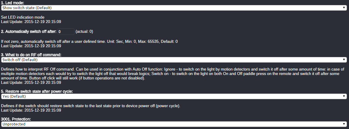

When turning connected load on/off by hand (pressing button), status of switch in Domoticz is updated without polling which is nice.
Configuration:
POPP 123627 wallplug

Conclusion
Works good, also nice that switch status in Domoticz is updated in Domoticz. Also seems to repeate for other nodes. For the price a very good unit!

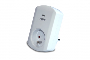

I (as a NL citizen) bought the BE/FR version (with earthpin), but that doesn't matter. Most of the plugs will fit in, as they already have a hole for the earthpin.

Can you change the 3001 value in the GUI?
Those high numbers in generally suggest a Command Class version mismatch
(OpenZwave assumes version 1, but the device has a higher version: something for the device specific file)
It looks like the TKB TZ68 (under Wenzhou in the Config directory).
The config file is recently added but with a poor and incomplete, only LED as night light switching in the GUI

ThinkPad
Posts: 890
Re: Z-Wave factfile: POPP 123627 wallplug switch
Post by ThinkPad »
Domosapiens wrote:It looks like the TKB TZ68 (under Wenzhou in the Config directory).
http://products.z-wavealliance.org/products/37
Looks the same indeed. Popp = rebrand of the TKB? Or the other way round?
Domosapiens wrote:Can you change the 3001 value in the GUI?
Yes, the 3001 setting seems to stick if i change it.
