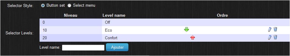

Just did a quick test to simulate heating swicth (Off / Eco / Confort). Couldn't make it working with blocky but works fine with Lua...
Create Selector Switch with Off / Eco / Confort level name and 3 virtual switches Heating / Heating Eco and Heating Confort
and a lua script
FYI I use Domoticz V2.3852
Will use it for bathroom heating control
Thanks for this new feature
JC

- jcjames13009
- Posts: 33
- Joined: Monday 09 March 2015 15:24
- Domoticz version: 2023.2
- Location: France / Marseille
Re: Mode-selector / multistate device
Hi SQ9MDD
That's the config I use (Dummy switch). I don't have mysensor.
JC
JC

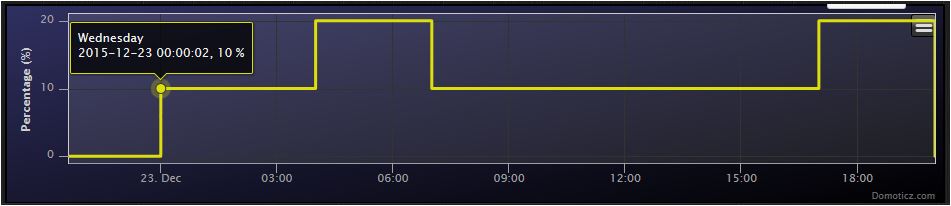

Still testing...
Planing is working fine with dummy selector switch
and blocky as well
Just multistate icon is missing. Sure we'll have it soon
JC
and blocky as well
2015-12-23 22:06:49.445 Selector Switch sur Eco
2015-12-23 22:06:49.445 EventSystem: Event triggered: Selector SW_2
2015-12-23 22:06:49.159 (Virtuel) Light/Switch (Selector Switch 2)
2015-12-23 22:07:34.096 Selector Switch sur Confort
2015-12-23 22:07:34.096 EventSystem: Event triggered: Selector SW_3
2015-12-23 22:07:33.871 (Virtuel) Light/Switch (Selector Switch 2)
2015-12-23 22:08:08.050 Selector Switch sur Off
2015-12-23 22:08:08.050 EventSystem: Event triggered: Selector SW_1
2015-12-23 22:08:07.843 (Virtuel) Light/Switch (Selector Switch 2)
