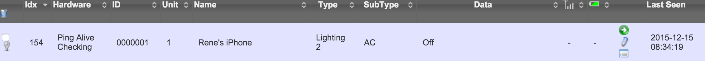

Strangely enough if I click on the green arrow button nothing is happening. Strange. Any idea's? I've not (yet) rebooted Domoticz, is that required?
Screen Shot 2015-12-15 at 10.00.04.png (64.88 KiB) Viewed 1073 times

I guess it has to do with your Name with the apostrophe. Try removing it, it could be interfering with apostrophes used in the code of Domoticz.

rednas wrote:I guess it has to do with your Name with the apostrophe. Try removing it, it could be interfering with apostrophes used in the code of Domoticz.
Excellent, that was the trick. Learned something again, thanks.
