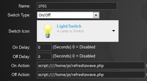

Create a file for each zwave device you want to update, ex refresh10.php
make it executable with sudo chmod +x refresh10.php
in the command on and off actions off domoticz add script:///path/to/script/refresh10.php

Hello @Egregius,
This does not work, here's what I have :
/home/pi/refreshzwave.php
#!/usr/lib/cgi-bin/php
<?php
file_get_contents('http://127.0.0.1:8080/json.htm?type=openzwavenodes&idx=3'); //Change IDX to IDX of your zwave controller
function RefreshZwave($node) {
	$zwaveurl='http://127.0.0.1:8080/ozwcp/refreshpost.html';
	$zwavedata=array('fun'=>'racp','node'=>$node);
	$zwaveoptions = array('http'=>array('header'=>'Content-Type: application/x-www-form-urlencoded\r\n','method'=>'POST','content'=>http_build_query($zwavedata),),);
	$zwavecontext=stream_context_create($zwaveoptions);
	for ($k=1;$k<=5;$k++){sleep(2);$result=file_get_contents($zwaveurl,false,$zwavecontext);if($result=='OK') break;}
RefreshZwave(100); //Change NodeID to NodeID of your zwave devices
RefreshZwave(101); //Change NodeID to NodeID of your zwave devices
RefreshZwave(102); //Change NodeID to NodeID of your zwave devices
What is not good in all this ? I do not understand why it does not work !!

You need the zwave node id, not the device idx.

I am trying this code as well because I have a Popp/Duwi dimmer which updates the value in Domoticz after change only after a while.
What is the function of this code in the php?
$devices=file_get_contents('http://127.0.0.1:8080/json.htm?type=openzwavenodes&idx=5'); //Change IDX to IDX of your zwave controller
It gives an error when you open the url (changed it to the right idx) and the $devices seems not be used anywhere else in the code.

Without it the second url fails after couple of days.
Try opening /ozwcp/cp.html directly without going first to hardware/zwave, it'll be a blank page.
In my latest version $devices is used to detect nodes marked as dead and send them a heal command.
