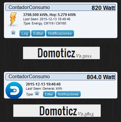

Hi all.
I am running version domoticz 2.3011 in raspberry pi 2.
Yesterday I downloaded the latest version available, and compile ok. Upgrade to version 2.3815.
When I am about to display the log of consumption, I see no longer appears on the "Log" button.
Where is that information now? or will no longer be available.
Consumption data is read through RFXCOM433 with owl CM119.
Thank you.
A greeting.
Historical use the meter Owl CM119 with RfxCom433.
- Consumo.jpg (33.86 KiB) Viewed 1817 times

Re: Historical use the meter Owl CM119 with RfxCom433.
could you clean your browser cache ? maybe this helps
I've cleared the browser cache, but it still appears the same.
Send you a PM for a database backup request
Good afternoon.
I've fixed the problem.
Really I do not know where the mistake was.
I installed the version 2.3530, I copied my domoticz.db and it works.
