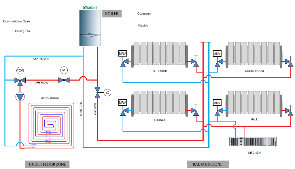

StanHD wrote:The newer version is called the "Honeywell evohome Connected Thermostat "
I have this version working for 2 months now and it is connected to Domoticz via the HGI80.
I Like it a lot as a control system, I like it even more because of the Domoticz integration. :D
StanHD are you willing to share your first base picture Image
StanHD
Posts: 347
Location: East Sussex, UK
Re: New Evohome kit compatible?
Post by StanHD »
Attached base picture. It's just made up in a paint programme. ;)
