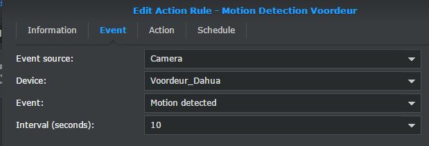

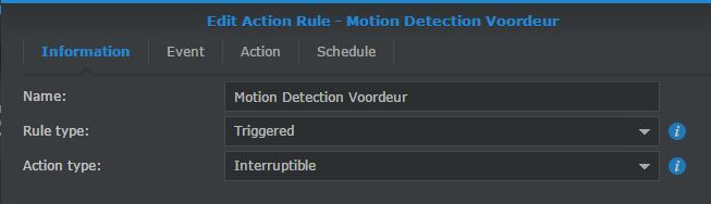

Re: IP Camera motion detection (Synology Action Rule)
Post by sincze »
Hi.
Surveillance Station offers some nice features since version 7.0
https://www.synology.com/en-global/surveillance/7.0
If you don't know where to look you will miss all the fun.
It enables you to have your IP camera as a motion detection sensor (finally :D ).
In this scenario if motion is detected by an IP camera (voordeur). Surveilance station will switch a virtual device in domoticz and the rest can be done in Domoticz ofcourse.
(Switch on front door light for example)
Action Rule - Call Domoticz virtual Switch
Action Rule - What to do and when
Action Rule
Action Rule

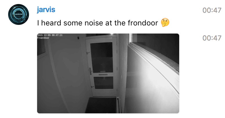

I recently bought the Foscam C1 which has SOUND detection as well, thought I'd modify your script a bit and share it here:
#!/bin/bash
FOSCAMIP="xxx.xxx.xxx.xxx"
FOSCAM_PORT="88"
FOSCAM_USER="xxxx"
FOSCAM_PASS="xxxx"
DOMO_IP="xxx.xxx.xxx.xxx"
DOMO_PORT="8080"
DOMO_USER="xxxx"
DOMO_PASS="xxxx"
FOSCAM_STATUS_IDX="xxx"
#foscam sound detection loop is 5s by default. 5s * 12 = 1 minute (for cron can only schedule every minute)
for i in {1..12}
do
if ping -c 1 $FOSCAMIP &> /dev/null
then
curl "http://$FOSCAMIP:$FOSCAM_PORT/cgi-bin/CGIProxy.fcgi?cmd=getDevState&usr=$FOSCAM_USER&pwd=$FOSCAM_PASS" > Foscam.txt
# use motionDetectAlarm instead of soundAlarm for motion and change foscam detection loop and sleep multiplier accordingly :)
FOSCAMStatus=`grep -oP '(?<=<soundAlarm>).*(?=<\/soundAlarm>)' Foscam.txt`
if [ $FOSCAMStatus = "2" ];
then
curl -s -i -H "Accept: application/json" "http://$DOMO_USER:$DOMO_PASS@$DOMO_IP:$DOMO_PORT/json.htm?type=command&param=switchlight&idx=$FOSCAM_STATUS_IDX&switchcmd=On&level=0"
fi
fi
sleep 5
done
I decided just to create a fake motion detector which turns off after 5s (don't need script for that ;) )
And, even more awesome, when there's SOUND detected at the cam it sends a snapshot to my Telegram! (Some additional scripting required of-course ;) )
Screen Shot 2015-12-09 at 01.14.33.png (120.75 KiB) Viewed 26964 times
Thanks for the script & inspiration, it works brilliantly!

sincze wrote:
G3rard wrote:@sincze, the motion detection feature linked to Domoticz is very nice. Thanks for sharing!
A sorry.
It was not complete
Motion Detection On:
http://<domoticz-ip>:<domoticz-port>/json.htm?type=command&param=switchlight&idx=ID_OF_SWITCH&switchcmd=On&level=0
Most of it came directly from the great domoticz wiki ofcourse.
Motion Detection OFF (or reset of the switch can be done by domoticz after for example 60 seconds)
How do you set the Motion Dectection to OFF with Domoticz ? Once it's on ON, I didn't succeed to reset it after 1mn.
What I did in Domoticz:
I click on Timers on my virtual light device
I have defined:
Enabled: YES
Type: On Time
Time: 00:01
Randomness: NO
Command: Off
When: Everyday
G3rard
Posts: 669
Domoticz version: No
Post by G3rard »
Don't use the timer for this. Remove the timer you have added.
Then choose the Edit button of the switch and set the Off delay to 60 sec.
