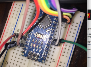

The sketch is the one include in 1.5.
Pin 5 and 6 are unused with me. See attached picture.
