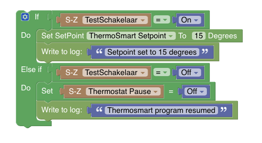

I also use this device and like it very much.
But i cannot find any sollution to set the temperature in an event in blockly or lua.
I want to create a switch when pressed the temperature is set to 15degrees.
Anybody can help me?

Post by Bikey »
This is an easy one: I think this is what you are looking for (tested it and it works):
Notice that if you set the setpoint manually, the program is paused. So therefore I added the "Else" clause to unpause the program again.

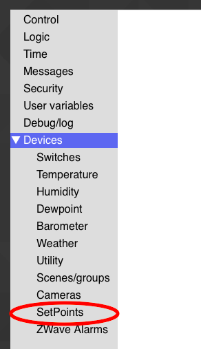

It should be in devices. If not you probably need an update of Domoticz:

Post by mrefex »
I just went to a beta update 3.7041 and still i don't see these two new options..setpoints and Zwave Alarms . refreshed the browser but nothing more...
i don't get it...
** CLEARED BROWSER CACHE ** now it's all visible... :lol:
