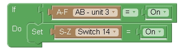

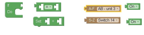

Now you have to make an Event. Go to Setup-More Options-Events. In this screen you can build the intelligence. I've uploaded an image where you can see the pieces I put together. In my screenprints you'll see AB - unit 3, which is my remote unit 3 button, and Switch 14, which is one of my receivers.
Give the event a name, tick the box "Event active" en click Save.
Now, when you press the On button on the remote, the receiver will switch on.

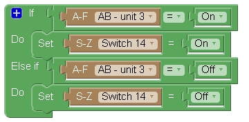

To turn it off, you can make a second event. But you can also change the first event to an Else If statement:
seppil
