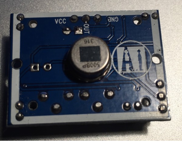

Im sorry for such a bad description Gizmocuz. A little frustration makes me stupid.
I think the stupidity extended to turning sensitivity pot wrong direction to decrease. After adjustment, it appears to be ok. Will see over time.
fwiw here is a picture I should have added on first post. (minus lens to see logo)
pir image.jpg (71.32 KiB) Viewed 1827 times
