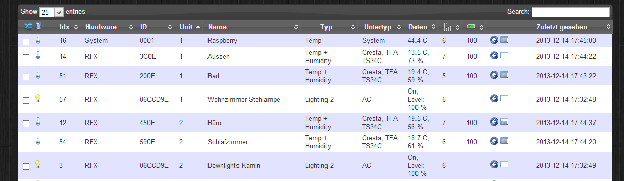

I see "It works" but how to proceed?
Any real life config.php out there? (maybe PM)
Would be helpful for me because I'm not sure how device is set in "$conf['blocks']['sensors'][]="DEVICE_ID_7";"
In the Domoticz device list are devices with same ID and a additional unit number, how should I change "DEVICE_ID" using ID and unit number?
Last edited by jkimmel on Saturday 14 December 2013 18:26, edited 1 time in total.

Post by wxop »
use the long id printed in the device list, ie command_switch_7
Developer of phpMyDomo, a Web Interface for Domoticz

wxop wrote:use the long id printed in the device list, ie command_switch_7
Is there a different devicelist somewhere here I don't find something similar to "command_switch_7"
Screenshot (15)_1.png (65.27 KiB) Viewed 5919 times

Post by wxop »
look in the device page of PMD

wxop wrote:look in the device page of PMD
I'm really sorry. But I don't have the slightest idea what PMD could be.
Edit: By chance I opened Ip-address/index.php and my devices were visible. Don't know yet how to edit if already possible.
