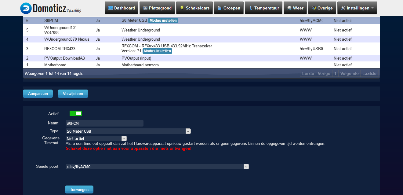

After repeated setting of a new SD-image, loading latest beta-release and setup for 'Hardware' and 'Devices' (and in the latest round the setting of the IP-address to a fixed value), it seems that my configuration is now stable (again). Based on this experience my (personal) opinion: fixed IP-address and Http-call to be preferred over DHCP in combination with Https-call. (In hindsight) http is sufficient for application on LAN, while Https may be safer for remote access from internet. The combination of Fixed IP-adress & Http is visibly faster, less prone to error.
Under 'Hardware' the serial port for S0PCM now set to ttyACM0, but under 'Devices' still I do not see a sign of S0PCM.
Neither do I see in the log something looking like a link to S0PCM.
Wiki and Manual do not give guidance beyond the first steps of S0PCM-installation in 'Hardware'.
Therefore assistance requested from earlier S0PCM-users: how to proceed? Examples?

For change of port-settings for S0PCM interface
1) click tab 'Instellingen' ( ~Setup)
2) select Hardware
3) click the line for S0PCM => picture below
4) then go to menu at bottom
5) scroll for required interface type for serial port
6) click 'Aanpassen', or equivalent button in the menu
2) select Hardware

Re: S0PCM-5 setup
Hey, thanks for the explanation. I can only choose for USB1, USB2 or USB0. I have chosen for /dev/ttyUSB2.
Any conclusions because of the output of the readings I get? The serial port seems to function?
Thanks again for helping
