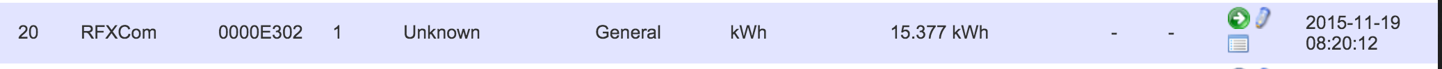

I've got an RFXCOM connected to Domoticz on a Pi 2. I also have an OWL CM160 with a single sensor that talks to an in-house display. the RFX is sensing the data from OWL but it isn't decoding it. The device shows up as "General"/"kWh and the data is incorrect. I think it's just showing total energy.
Any ideas on how to debug this?

Please try with RFXmngr and only the Oregon protocol enabled.

Also post some screenshots plz

The RFX is already set to only receive Oregon Scientific protocols
Hardware
Hardware
Hardware
Screenshot 2015-11-19 08.19.33.png (46.31 KiB) Viewed 1602 times
Devices
Devices
Devices
Screenshot 2015-11-19 08.21.04.png (34.06 KiB) Viewed 1602 times
Log
Log entry
Log entry
Screenshot 2015-11-19 08.21.37.png (25.4 KiB) Viewed 1602 times
Sorry about the screen size of the images, but I don't know how to shrink them.
