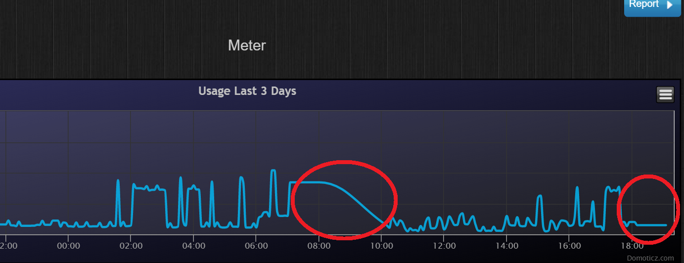

Does anyone use nrf24l01 connected directly to RPi2 as the gateway?
I have a strange problem. From time to time, all nodes stop reporting to the gateway at the same time. I understand this is not a problem of a node, but a problem with the gateway. Not sure where to look. Rebooting the nodes does not help, I have to reboot the RPi2 to make it work.
See the meter graph below. The circled areas is when there was no signal reception. The same goes for the temperature.
I am using MySensors 1.4 lib - this is the newest for the RPi2 unfortunately.
Any thoughts?
Any thoughts?
- Screenshot (4).png (241.63 KiB) Viewed 6002 times

i had (have) this problem as well.
thats why i build a queue system in the latest domoticz beta that sends the messages.
But it does not seem to make a difference.....
I am using a sketch that requests a lot of data from domoticz (via V_CUSTOM, see the form post about my lcd sketch)
After some time, the communication stops
I now build an Ethernet gateway, and going to test if this keeps 'alive'

Thanks for confirm it Rob!gizmocuz wrote:i had (have) this problem as well.
The problem is that I spent a lot of time on this and somehow I feel that due to MS version 1.4 (already behind 1.5 stable and 1.6 development) there may be some bugs left. I am not sure this would be supported in the future either.
This is the reason I decided to move on to the ethernet gateway - this runs flawlessly. Unfortunately, this means now that I have to buy an internet switch as all ports on my router are taken. Having 'keep alive' would be great. I like the way Domoticz is logging a serial gateway if it is disconnected.
