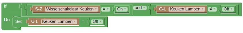

I´m trying to use the second switch input on a Qubino dimmer to work as a secundary switch for my kitchen lights.
In dutch called a `wissel schakeling`.
The problem is that the kitchen light is always dimmed to +/- 50% when on. So the state in Domoticz is not Always "ON" but sometimes
showed as 50%.
When i'm trying this blocky script I get a error.
Error:
Name: Wisselkeuken => [string "result = 0; weekday = os.date('*t')['wday']; ..."]:1: attempt to compare string with number
Script error blocky, compare number with string
- blocky.jpg (24.46 KiB) Viewed 1103 times

Hi koenjer,
try this:
EDIT: but I think it won't work as expected. Because when the Wisselschakelaar Keuken is On and you activate the dimmer, the script will turn the light of again. You can probably fix that by setting the Off Delay to let's say 5 seconds, so it will turn off automaticaly. Then you will be able to use the other switch to turn the lights on again.
try this:
