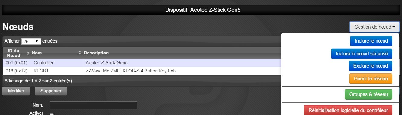

the device is awake when you do this ?
can you make a sceen shot like this ?
- kfob.jpg (73.96 KiB) Viewed 3540 times

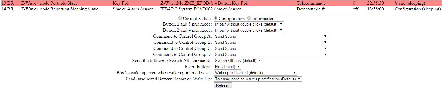

i use kfob.xml.
do u try to exclude, reset and re include properly ?
do u delete line of the kfob in the file zwcfg_XXXXX.xml ?
Parameters are ok ?
Its a battery node so the timeout is not a problem.
- exclude
- include
- wake up
-set parameters in DZ and send it
- wake up for parameters
Normaly it works....
Parameters are ok ?
- exclude
- include
- wake up

This morning sun is shining and kfob is back to life
after another exclude restet include etc...
I did the following :
starting state is kfob inclued but muted
1 :delete all UNUSED devices from domoticz (as i supected a kind of conlict on this)
2 : without deletion or exclusion : include the kfob again
3 : Setup manualy association for the Five groups to the controller node 1
4 : wake up the kfob...done!
I can see many devices switch as before !
find here log....

Marvellous.
It works.
Thanks a lot fpatou.
I hadn't do step 1 (not able to deleted my very few unsued devices such as old motherboard sensors, this kfob is my first OZW device).
For step 3, I try using "Group & Network" from my Zwave Controller and set node 1 to each group and then apply configuration to my kfob. Is that the way you do ? When I go back "Goup & Network", I don't see my change.
But it works. I've 15 new devices (curiously, it misses only double click on button 4).
Thanks a lot again fpatou. You're my hero
It works.
fpatou
- Posts: 16
- Joined: Tuesday 03 November 2015 20:34
Re: Z-Wave.Me ZME_KFOB-S 4 Button Key Fob
step 4 :wake up the kfob...4 bnt and then btn 2 to update kfob config and see changes in groups associations
From there kfob remote my SONOS
and a heater !!!
Comme quoi qd on cherche ...on trouve !
