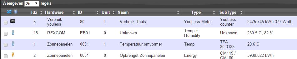

I'm new to Domoticz. I bought myself a RFXtrx433E(v242) and also the sensor + weather station of Blokker.
I receive the following in Domoticz? I don't think the temp is 230,5 outside at the moment it's only 14,5 outside. I've seen it show different temperatures between 0 and now 230 and maybe up....
Am I doing something wrong?

Hurr1c4n3 wrote:I'm new to Domoticz. I bought myself a RFXtrx433E(v242) and also the sensor + weather station of Blokker.
Did you solve this issue? I'm having the same problem with the RFXCOM E version, firmware 242 and the original WS-1700. I connected the RFXCOM to my laptop and the sensor is detected as type TH14 (WS4500). But in the topic I noticed their WS-1700 is detected as TH13. Could that be the issue?

I've had contact with RFXcom. They're testing a new firmware (v243) to fix this issue (incorrect values on WS-1700). It should be out soon.
