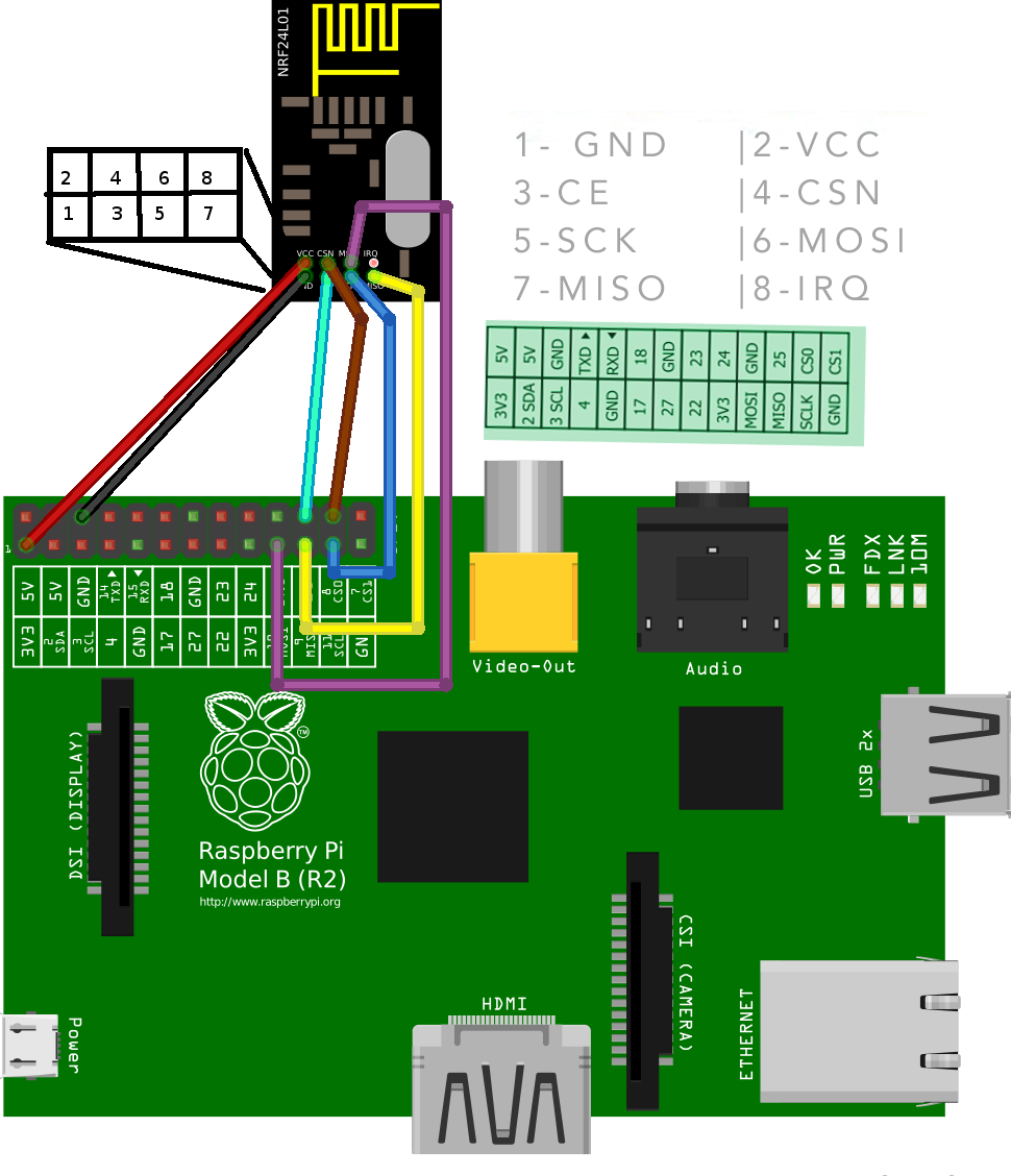

Post by asm7100 »
Justintime wrote:
BluesBro wrote:Is there a way to skip ardunio via serial and connect the nrf24 directly to the Pi?
No, you have to have a serial gateway which communicates with the nodes. The serial gateway talks with Domoticz.
Yes there is.
Bout you need a driver.
The NRF24 is used on this site.
http://iot-playground.com/3-easyiot-server-installation
He is going cloud based and properly want money for the service in 2016.
NRF24 Connectet to Raspberry.

Post by gizmocuz »
I think mysensors 1.6 will let you do this...

Post by asm7100 »
Domoticz needs a driver for it :-)

Post by gizmocuz »
is it ? From what i hear is that 1.6 lets you connect directly to your sketch.
(you cant use serial debug prints, unless you specify this)
If i'm wrong let me know... at the moment i can not compile any sketch in 1.6 (radio/hw not found in mysensors.cpp)
But there are positive responses from users

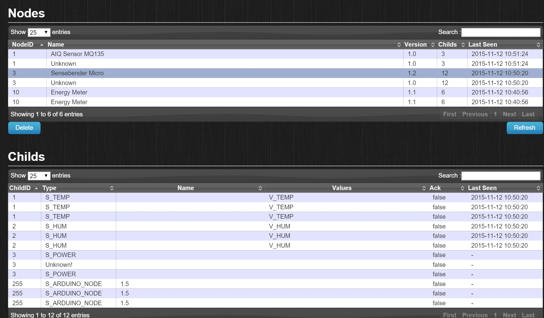

Post by alexsh1 »
I have the ethernet GW connected to Domoticz and have the following issue (please see the photo attached).
Any ideas why I have nodes /childs duplicated? I am running MySensors 1.5 lib.
Screenshot (5).png (295.43 KiB) Viewed 5884 times

Post by gizmocuz »
No... not really
You can remove both nodes... does it come back twice?
