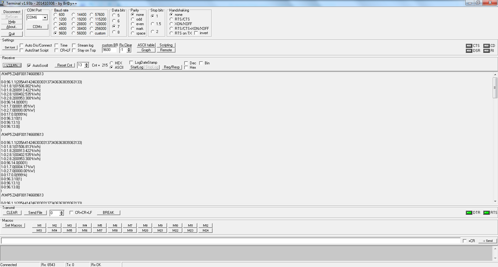

Thanks! 115200 didn't work but I tried playing around with the other settings and when I set Data bits to 7 (instead of 8) I got sensible data at Baud rate 9600 (see attachment). So I guess the cable is fine. I'll connect it to domoticz again and see if it works now.
- terminal screen shot
- terminalScreenshot.png (80.88 KiB) Viewed 13421 times

It Works.
What I mean is that I see the values of the electricity and gas meters .
I had no need for the additional components I have just connected pin 2, pin 5 and pin 7 (2=Rx, 5=GND and 7=Vcc)
one question, my electric meter has a day and night tarrif. How is this displayed in Domoticz?
Have to say tat this is very easy!

Draakje
- Posts: 140
- Joined: Thursday 22 October 2015 21:14
- Domoticz version: 4.11539
Re: DIY cheap USB-cable to read P1 port of Dutch smart meter
Yes sorry for non english.
What I mean is a day and night meter. I believe it is T1 and T2 ?
Maybe it is just contiguous measuring but only in calculation it will use the two tariffs...
So my next step is getting the info off the water meter
But, like you , I want to have the sensor via ethernet so I have ordered a serial to ethernet from china will take about 2 weeks to get here..
thanks for all the help
