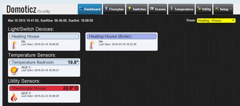

Nice one.
while reading this I noticed that the HE105 looked exactly like the Boiler switch that I have in my house which is branded as a 'Horstmann HRFS1' - Like this one http://www.screwfix.com/p/horstmann-hrf ... stat/93829.
It turns out that it is the same receiver/switch unit as the HE105 and that I can also switch it with rfxmgr and have just managed to add a switch in my domoticz to control it :)
I have had this thermostat for years (using the seperate LCD display to control it), and never realised that the 'thermostat' tab was there in rfxmgr or that I could control it! Now I can start playing with it!

My other question is how you get the yellow marked dropdown menu in the top right hand corner that says " Room ; Heating House " ?
I assume you have the dashboard devided in several pages?
Paco
thebeetleuk
Posts: 115
Joined: Saturday 21 December 2013 23:50
Location: Scotland
Heating finally automated using HomeEasy HE105
Post by thebeetleuk »
To setup rooms just go to the following location in the web interface
Setup-->More Options-->Plans-->Room Plan
Now just create a room and add items to it :)
P.s. I'll change the 600 :)
