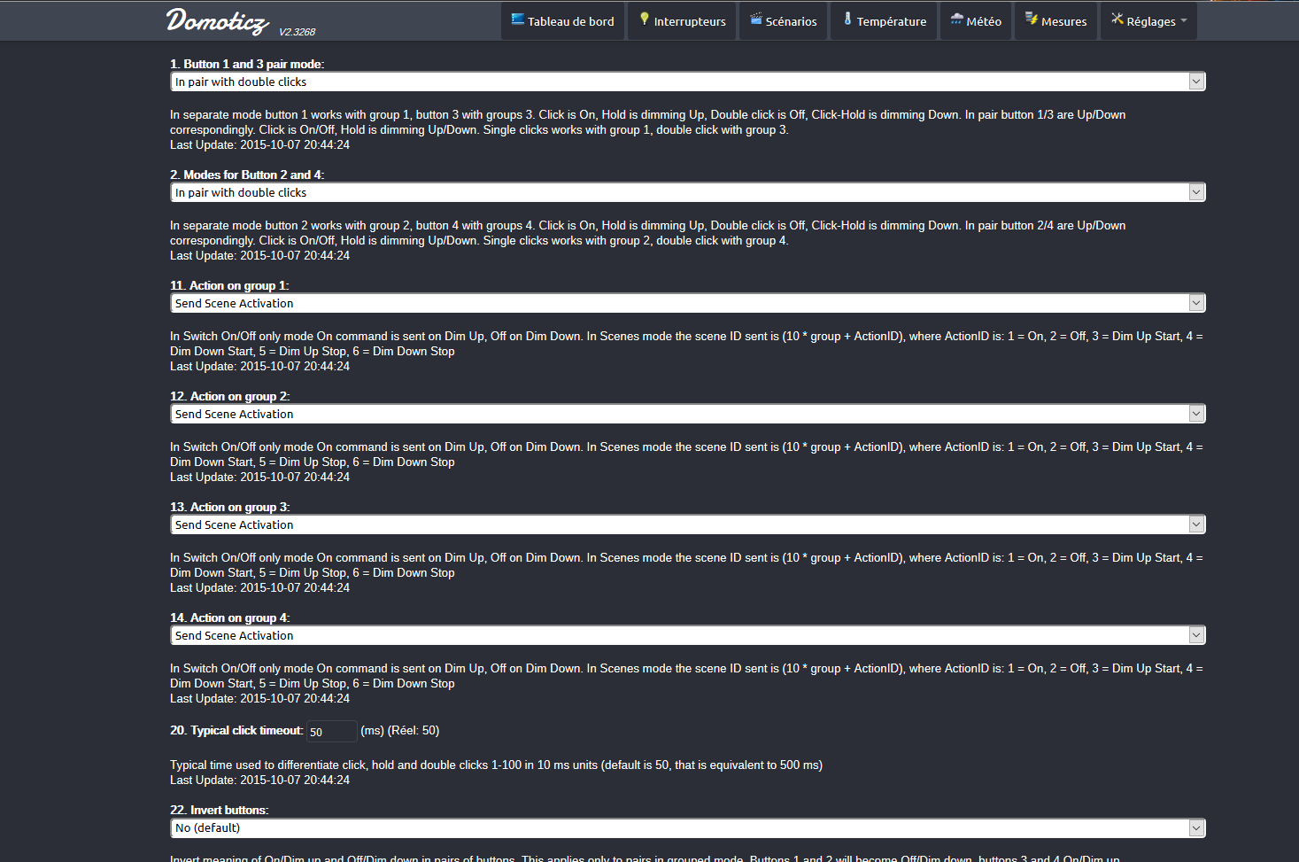

you must set parameters like this, u will have simple click, double click, long click and release :

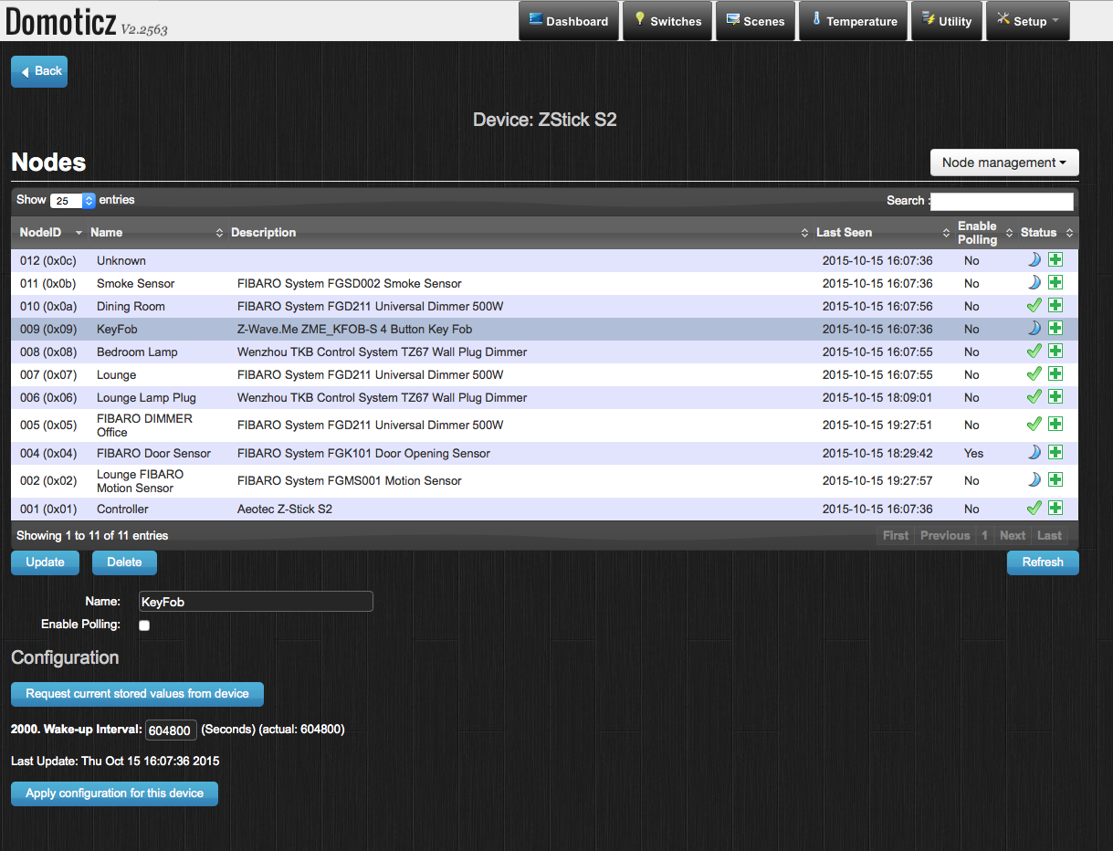

Hi I have the same key fob but although I have managed to get it paired on my Raspberry Pi with a USB Stick S2 when I select the KeyFob in the nodes list I get no configuration options other that the wake time.
I have checked the my zwcfg*.xml file and can see its recognised as the correct device..
So next I checked the manufacturer_specific.xml file to ensure its pointing to the correct config xml file but it wasn't so I pointed this to the zwave.me/kfob.xml file as in the config below
Then even though I have carried out multiple reboots and checked that the wave.me/kfob.xml is there its still not bringing up the configuration options and I also see no buttons in my device list for this node.
Does anyone have any ideas as finding it a little frustrating. Im running Domoticz v2.2563 which I believe is the latest version. Any help would be greatly appreciated.
- Screen Shot 2015-10-15 at 19.40.57.png (391.3 KiB) Viewed 8274 times

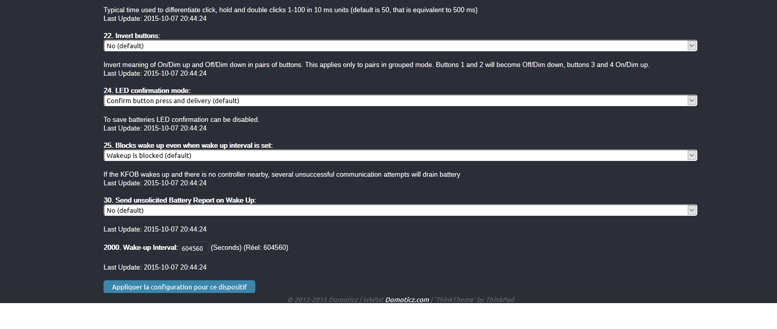

Exclude and re include your device.
Set the parameters like the screenshot, u must wake up the kfob.
And then click on 1 button, a new switch must appear.

u click one time on button 1 -> 1 switch will be created in the device panel
u double click on button 1 -> 1 switch will be created in the device panel
u long click on button 1 -> 1 switch will be created in the device panel
u release after long click on button 1 -> 1 switch will be created in the device panel
same for the other buttons...

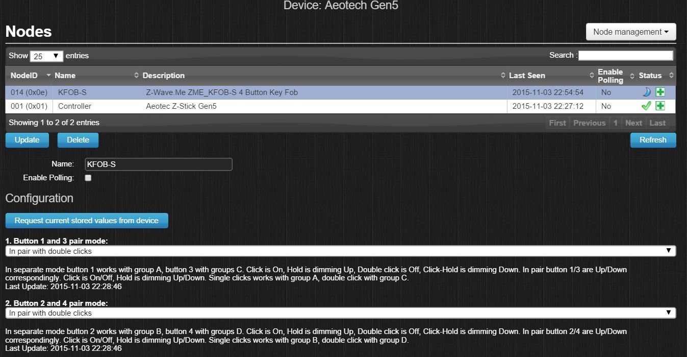

You're right fpatou, there are some minor changes for the configuration of a ZME_KFOB-S version.
I join the config I've set in accordance with ben92 advices for a ZME_KFOB.
For ben92, I'm sorry to be so noob, but when and/or where (on which screen) should I have to click on a kfob button to register the device ? On "scenes" tab or "switches" tab ?
