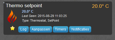

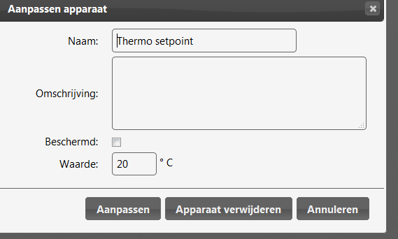

Is it possible to make a temperature adjustment in the thermo setpoint icon instead of going first to "aanpassen"?
