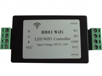

I received mine today, and it works nicely with the 'LEDDimmer.apk' app.
For those who don't know the device: it is a RGB-dimmer through WiFi, based on the popular ESP8266 chip. In the default mode it presents itself as an accespoint and you connect your phone to it.
Productpage (translated from Chinese > English) (also saved PDF-file as mirror, attached to this post).
However, instead of connecting my Android phone to the accespoint-mode of this dimmer, i ofcourse would like to connect it to Domoticz 8-)

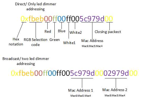

Setting the red channel to max: fbebff0000000079979d00
Setting the red channel to zero: fbeb000000000079979d00
So the first value after the 'fbeb' changes to 'FF', which equals to 255 :mrgreen:
Setting the green channel from zero to max shows fbeb00ff00000079979d00
Setting the blue channel from zero to max shows fbeb0000ff000079979d00
If i set it to '124' through the app, it is shown as '7c'. So it seems all the values are converted from decimal (in the app), to hex (UDP packet).
So the protocol seems very easy actually..... I am now trying to send these packets myself, with sendip, but that isn't working yet.

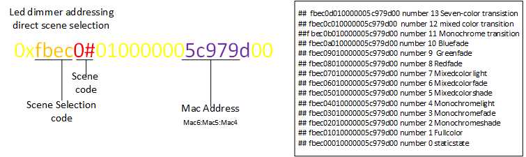

To get it back from the disco-mode programs into the mode where it accepts colors from the colorpicker-wheel:
0xfbec001e00000079979d00
(sent 2 times by app)

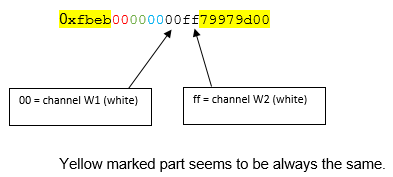

It also has two channels for white LED's, called 'W1' and 'W2' in the app & on the box. It can be used by VCC + W1 and VCC + W2
Channel W1 to max
0xfbeb000000ff0079979d00
Channel W1 to zero
0xfbeb000000000079979d00
Channel W2 to max
0xfbeb00000000ff79979d00
Channel W2 to zero

So, am i the only one on this forum with this cool device :roll: ?
It's only 10 bucks and has 5 channels (R, G, B + white1 + white2) :D

Indeed a great and cheap Wi-Fi dimmer and thanks Thinkpad and others for the information to integrate this into Domoticz.
The packet layout is a tad different as the picture above in the forum. The 3 hex numbers in the package are the led dimmer Mac address in the form of MAc6:MAc5:Mac4. this with a trailer 00 to close the package.
After the last 00 hex another MAC address can be added if you address the dimmers in a broadcast ( 192.168.2.255). I have added a explaining picture.
I also attach my code how I integrated these led dimmers in domoticz. Integration is done by creating a virtual on/off switch with the main ( almost always used) color code and some scene's to change them to another color.
Since I run stable I have not bothered yet with the RGB pop switch. however I presume this together with a LUA script can interact as well for full rgb color selection.
led-dimmer packet layout.jpg (20.03 KiB) Viewed 40810 times
Led dimmer addressing.jpg (32.08 KiB) Viewed 40810 times

# dependency fping and netcat (nc)
# format hex string to led dimmer for color "fbeb RRGGBB WW(1) WW(2) MM(6) MM(5) MM(4) 00 " ( for multiple add the next 3 MAC otects MM(6) MM(5) MM(4) 00
# where "fbeb" is  rgb color and "fbec" is fixed modes
# RR=Red, GG=Green, BB=Blue, WW(1)=White1, WW(2)=White2,  MM(6)=Mac octet 6, MM(5)=Mac octet 5, MM(4)=Mac octet4
# e.g fbeb00000000005c979d00ad1a0200 or fbeb00000000005c979d00
# Input script example h801-leddimmer.sh 192.168.2.121 ad1a02 264 rgbww ff20000a00
