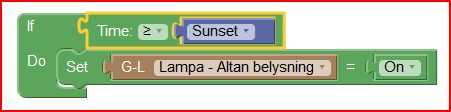

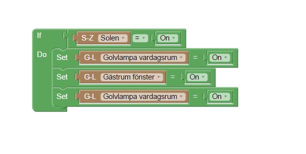

I´m a totally newbie on Domoticz and Blockly. Just want to start with a simple example which isn´t working.
I have set up a dummy-switch which is called "solen", ON when the sun is down and off during the day, based on sunrise. The dummy works fine, status changed when the sun goes down.
Why won´t this simple example work? The lamps won´t light up.
The event is active, anything else I must configure to get events working? I´m running a Rasp Pi.

Hej or Hello....
Why not do this way:

I have read it´s better to have a dummy-swith. But, just too confirm, everything looks fine in my example?
Minglarn
Posts: 214
Domoticz version: v3.8153
Location: Stockholm / Sweden
Re: Blockly examples
Post by Minglarn »
It looks just fine! Should work...
