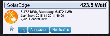

Crusader2003
Joined: Friday 20 November 2015 10:34
Re: SolarEdge in Latest Beta / Port Number
Post by Crusader2003 »
Thank you Antwan,
Your script works fine.
screenshot
screenshot
antwan wrote:Change in your inverter the url from:
prod.solaredge.com
to the ip addres of your domoticz server.
In Domoticz put at remote address:
Remote Address: prod.solaredge.com
Port: 22222
For me this is a intermediate solution. In the end I want to connect to the rs232 or usb port on the inverter and leave the ip part on the inverter like it was.
The advantage of this is that the data is coming in every 0,5 sec (the same intervall as on the display).
We still have to integrate the optimisers in Domoticz.
