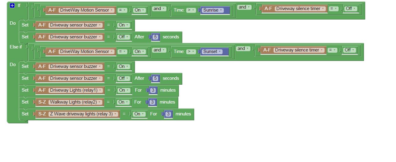

Here is my setup for a driveway buried magnetic sensor that alerts me with a tone when someone drives up my driveway....
I have a few motion sensors, but this one has no persistence like somePIR do, so it is identical to your doorbell. My event fires a 433Mhz buzzer in my home, then turns it off after 5 seconds. It works really well.
It seems you are trying to do same thing as I was.
