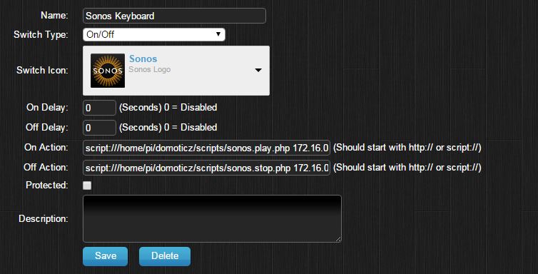

G3rard wrote:Php files can be called from a switch, I am using that but you have to run the php from a web server like a Synology and use http:// instead of script://.
got it all working. Created 2 dummy switches for each Sonos. And in Blocky sent a command when the doorbel is rang!
Even when the both speakers are streaming radio in a Group, when the doorbell rings, the sonos speakers stop each nicely, play the doorbell mp3 and afterwards continue to play the radio stream!!!
Cheers for the solution from this German guy!!! And thanks G3rard for pointing me to the solution!

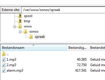

Play message
http://yourserver/sonos/index.php?zone= ... &volume=20
The Google TTS service doesn't work anymore gives me HTTP 404 errors?? But i just downloaded my own doorbell mp3. You need to name it 0.mp3 (and use messageID1) and place it in the correct locations.
Seems every message had a 0 status (start action) and a 1 status (action stopped). For a doorbell you just need 0.mp3 and messageId1

Hi, I've modified the stop and play scripts. You can use these scripts with an IP as parameter. These scripts also writes a line in the log file.
Place the scripts in: /home/pi/domoticz/scripts
Make the scipts executable: chmod +x <filename>
You can start them via a switch.
#!/usr/bin/php
<?php
// Play SONOS device with given IP adres
//  f.e. in Domoticz switch enter by on action : script:///home/pi/domoticz/scripts/sonos.play.php 172.16.0.11
//  Uses curl. Maybe you havbe to install curl: sudo apt-get install php5-curl

Hi, a developed an alarm script for the Sonos. You can use these scripts with an IP as parameter. This scripts also writes a line in the log file.
You can download free sounds on the web. Save one of them to f.e. as alarm.mp3
A webdirectory on the RPI is necessary. See the attachement for a example
xxx.xx.x.xx in the script is the IP address of your RPI (Domoticz). pppp the port number.
