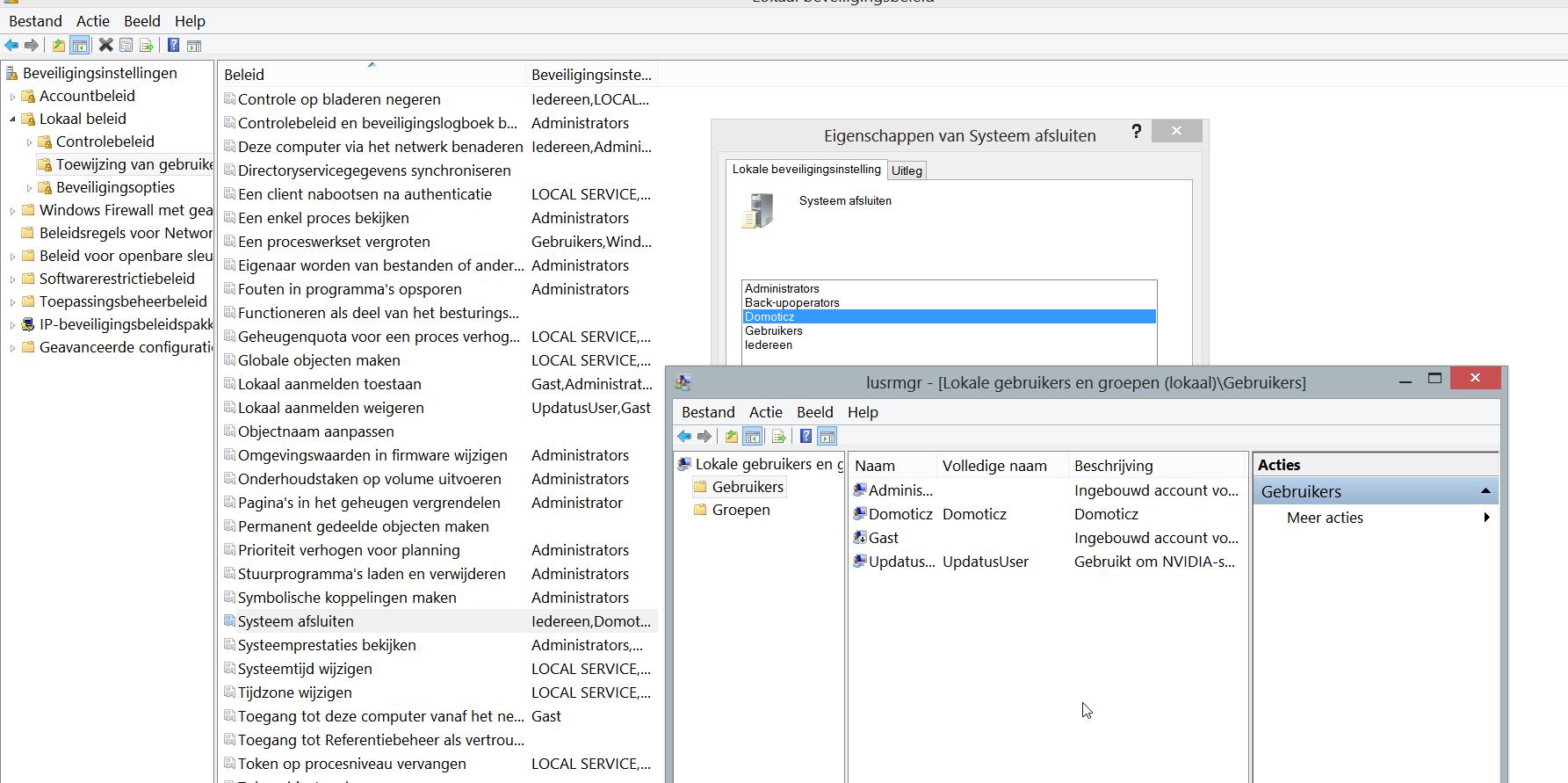

Whitout a password, user non admin.
Create a new normal user without password
Windows key + R
lusrmgr.msc
(users folder right button --> create user)
untick (user change pass next logon) and tick (password never expires, and cannot change pass)

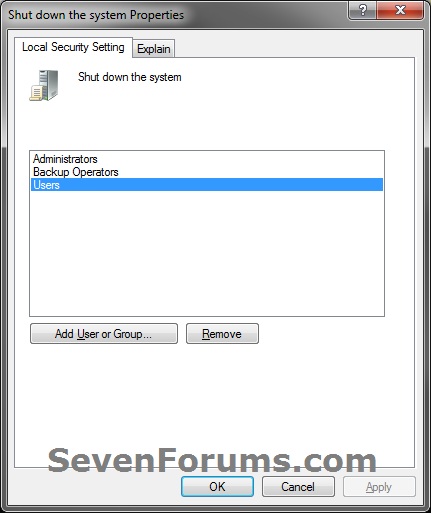

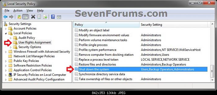

If your windows 7 are professional or ultimate (not for home edition)
Windows key + R
secpol.msc
Add your user to this policies
"force shutdown from remote ...."
and
"Shutdown the system"
reboot
try
net rpc -S 192.168.1.xx -U king% shutdown -t 1 -f
If doesn't work add pasword for this user and search info to remove other permissions like create profiles or install apps (to no compromise this system).
Sorry my english :)
I'm att office, i test later in home.

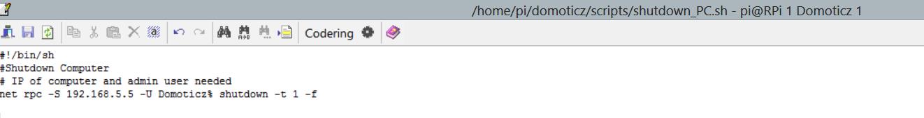

I did:
And:
And the RPi stuf...
chmod etc.
And i get:
pi@raspberrypi ~ $ net rpc -S 192.168.5.5 -U Domoticz% shutdown -t 1 -f
Could not connect to server 192.168.5.5
Connection failed: NT_STATUS_ACCOUNT_RESTRICTION
The problem is the regfile... [ i guess ]

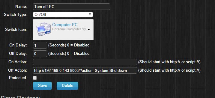

Why not use this: http://www.domotica-blog.nl/post/pc-net ... ia-zipabox
Seems quite easy.... Put the HTTP URL in a virtual switch.
Just wondering if anyone was using this.
I tried to use it by putting in the "http://XXX.XXX.X.X:8000/?action=System.Shutdown"
It is in the "off action" of the switch but when I click it nothing happens.
If I paste the address into my browser, it shuts the machine down no problem.
DO I need to do anything with the http link in the off action part of the switch??

I tried to use the manual from raxor to shutdown my windows PC with a off button in Domoticz but nothing happens. when I use the command from the schript on shell it shuts down my PC as it should, so what did I miss?
I followed this step by step
I''ve the latest win 10 build (Insidder) and use Domoticz on my RPi.
Hope someone can help me.
