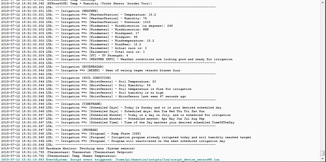

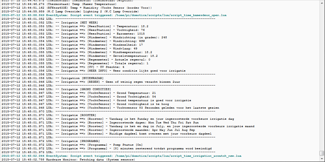

time = os.date("*t")
-- Settings Begin
-- Set your desired language (English, Dutch)
local lang = 'Dutch'
-- Lua script interval check, change the number 1 to every desired number in minutes
-- Logging:
-- 0 = None
-- 1 = Only critical
-- 2 = All
local logging = 2

	if logging == 1 then
		print("--------------------------------------------------------------------------------------")
		if lang == 'Dutch' then
		print("Irrigatie [HET WEER]");
		print("-- Irrigatie ==> [WeerStation] - Temperatuur: " .. sWeatherTemp .. " ");
		print("Irrigation [WEATHER]");
		print("-- Irrigation ==> [WeatherStation] - Temperature: " .. sWeatherTemp .. " ");
	if logging >= 2 then
		print("-- Irrigatie ==> [WeerStation] - Luchtvochtigheid: " .. sWeatherHumidity .. " ");
		print("-- Irrigatie ==> [WeerStation] - Barometer: " .. sWeatherPressure .. " ");
		print("-- Irrigation ==> [WeatherStation] - Humidity: " .. sWeatherHumidity .. " ");
		print("-- Irrigation ==> [WeatherStation] - Pressure: " .. sWeatherPressure .. " ");
		print("-- Irrigatie ==> [Regenmeter] - Regenval nu: " .. sRainmeterCurrent .. " ");
		print("-- Irrigatie ==> [Regenmeter] - Totale Regenval: " .. sRainmeterTotal .. " ");
		print("-- Irrigation ==> [Rainmeter] - Actual rain is: " .. sRainmeterCurrent .. " ");
		print("-- Irrigation ==> [Rainmeter] - Total rain is: " .. sRainmeterTotal .. " ");
-- UV data:
sUV, sSolar = otherdevices_svalues[uv]:match("([^;]+);([^;]+)")
sUV = tonumber(sUV);
sSolar = tonumber(sSolar);
	if logging >= 1 then
		print("-- Irrigatie ==> [UV] - UV Sterkte: " .. sUV .." ");
		print("-- Irrigation ==> [UV] - UV Strength is: " .. sUV .." ");
		print("Irrigatie [GROND CONDITIE]");
		print("-- Irrigatie ==> [VochtSensor] - Grond Temperatuur: " .. smoistsensorTemp .. " ");
		print("-- Irrigatie ==> [VochtSensor] - Grond Vochtigheid: " .. smoistsensorHumidity .. " ");
		print("Irrigation [SOIL CONDITION]");
		print("-- Irrigation ==> [MoistSensor] - Soil Temperature: " .. smoistsensorTemp .. " ");
		print("-- Irrigation ==> [MoistSensor] - Soil Humidity: " .. smoistsensorHumidity .. " ");

-- Checking Grond Temperature Conditions
if 	smoistsensorTemp >= tonumber (VarTarTempMin)
	and smoistsensorTemp <= tonumber (VarTarTempMax)
then
		print("-- Irrigatie ==> [VochtSensor] - Grond temperatuur is goed voor irrigatie");
		print("-- Irrigation ==> [MoistSensor] - Soil Temp conditions are fine for irrigation");

-- Checking Grond Humidity Conditions
if smoistsensorHumidity >= tonumber (VarMinHum) or smoistsensorHumidity <= tonumber (VarTarHum) or smoistsensorHumidity >= tonumber (VarTarHum)
then
		print("-- Irrigatie ==> [VochtSensor] - Grond vochtigheid is goed, geen irrigatie nodig");
		print("-- Irrigation ==> [MoistSensor] - Soil humidity is fine and doesn't need irrigation");

-- Checking Buienradar
if Buienradar == 'Yes' then
		print("Irrigatie [BUIENRADAR]");

-- Checking Time Frame
		print("Irrigatie [TIMEFRAME]");
		print("Irrigation [TIMEFRAME]");
if day == VarDay1 or day == VarDay2 or day == VarDay3 or day == VarDay4 or day == VarDay5 or day == VarDay6 or day == VarDay7
	then
		print(os.date("-- Irrigatie ==> [TimeFrame] - Vandaag is het %A en aangemerkt als irrigatie dag"))
	print(os.date("-- Irrigation ==> [TimeFrame] - Today is %A and it is a irrigation day"))

			commandArray['Variable:VarTimeOfDayCurrent']= '1'
	if (time.hour >= 20) and (time.hour <= 23)then
		if (uservariables['VarTimeOfDayCurrent'] ~= 2) then
			commandArray['Variable:VarTimeOfDayCurrent']= '2'
	if (time.hour >= 0) and (time.hour <= 5)then
		if (uservariables['VarTimeOfDayCurrent'] ~= 3) then
			commandArray['Variable:VarTimeOfDayCurrent']= '3'
	if (uservariables['VarTimeOfDayCurrent']) == tonumber (VarTimeOfDay) then
		print("-- Irrigatie ==> [TimeFrame] - Dit dagdeel komt overeen met jouw voorkeurs dagdeel voor irrigatie")
		print("-- Irrigation ==> [TimeFrame] - Time of the Day matches your desired irrigation value")
	if (uservariables['VarTimeCon']) == 0 then
	commandArray['Variable:VarTimeCon']= '1'
if (uservariables['VarTimeOfDayCurrent']) ~= tonumber (VarTimeOfDay) then
		print("-- Irrigatie ==> [TimeFrame] - Dit dagdeel komt niet overeen met jouw voorkeurs dagdeel")
		print("-- Irrigation ==> [TimeFrame] - Time of the Day doesnt match your criteria.")
		print('-- Irrigatie ==> [TimeFrame] - Programma wacht op het geschikte dagdeel')
		print('-- Irrigation ==> [TimeFrame] - Waiting for the right Time of the Day')
	if (uservariables['VarTimeCon']) == 1 then
	commandArray['Variable:VarTimeCon']= '0'
		print("Irrigatie [PROGRAMMA]");
		print("Irrigation [Program]");
-- Giving the irrigation program a Go or NoGo
if Buienradar == Yes then
		and (uservariables['VarTimeFrame']) == 1
		and (uservariables['VarTimeFrameMon']) == 1
		and (uservariables['VarWeatherCon']) == 1
		and (uservariables['VarMoistOnline']) == 1
		and (uservariables['VarMoistOnlineHum']) == 1
		and (uservariables['VarMoistConTemp']) == 1
		and (uservariables['VarBuienRadarCon']) == 1
	then
		print("-- Irrigatie [Condities] ==> Alle condities lijken goed, en het irrigatie programma mag vervolgt worden")
		print("-- Irrigation [Conditions] ==> All conditions seems to be okay, Irrigation may if needed continue program")
	if (uservariables['VarMayFollowProgram']) == 0
    then
		commandArray['Variable:VarMayFollowProgram']= '1'
		print("-- Irrigatie [Condities] ==> Niet alle condities lijken goed, en het irrigatie programma mag niet vervolgt worden")
		print("-- Irrigation [Conditions] ==> Not all conditions seems to be okay, Irrigation may NOT continue program")
	if (uservariables['VarMayFollowProgram']) == 1
    then
		commandArray['Variable:VarMayFollowProgram']= '0'
	then
    then
    then
-- Irrigatie Program Active
	and (uservariables['VarProgramRun']) == 0
	and (uservariables['VarProgramOverride']) == 0
	and (uservariables['VarManOverrideCon']) == 0
	then
if (uservariables['VarFollowsProgram']) == 0 then
	commandArray['Variable:VarFollowsProgram']= '1'
		print("-- Irrigatie [Programma] ==> Irrigatie Programma Geactiveerd...")
		print("-- Irrigatie [Programma] ==> Irrigatie pomp zal spoedig starten...")
		print("-- Irrigation [Program] ==> Irrigation Program Activated.")
		print("-- Irrigation [Program] ==> Irrigation pump will start in a minute...")
-- Irrigatie stopped after a full runtime cycle
if (uservariables['VarProgramRun']) == 1
	and (uservariables['VarProgramOverride']) == 1
then
		print("-- Irrigatie [Programma] ==> Irrigatie Gestopt, Pomp heeft de maximale looptijd overschreden...")
		print("-- Irrigatie [Programma] ==> Wachten op een nieuwe TimeFrame...")
		print("-- Irrigation [Program] ==> Irrigation Stopped, Maximum RunTime Exceeded...")
		print("-- Irrigation [Program] ==> Awaiting new TimeFrame...")
-- New timeframe so irrigation reactivated
	and (uservariables['VarMayFollowProgram']) == 0
	then
if (uservariables['VarProgramOverride']) == 1 then
	commandArray['Variable:VarProgramOverride']= '0'
		commandArray['Variable:VarProgramRun']= '0'
		print("-- Irrigatie [Programma] ==> Irrigatie Programma Gereactiveerd...")
-- Irrigatie stoppen, Regen Verwacht
local VarMaxRainFallAv = VarMaxRainFallPlus * 0.5 + VarMaxRainFall
if (uservariables['VarBuienRadarCon']) == 1 and (uservariables['VarProgramRun']) == 1 and RainPrediction >= tonumber (VarMaxRainFallAv)
	then
if (uservariables['VarProgramOverride']) == 0 then
	commandArray['Variable:VarProgramOverride']= '1'
	commandArray['Variable:VarMaxRunTime']= '-1000'
	commandArray[VarPump]='Off'
		print("-- Irrigatie [Programma] ==> Irrigatie Programma gestopt, Regen Verwacht...")
-- Irrigatie stopped as the moist humidity exceed your desired value
if smoistsensorHumidity >= tonumber (VarTarHum)
	then
		print("-- Irrigatie [Programma] ==> Irrigatie Programma Gestopt, Grond vochtigheid heeft zijn maximale waarde behaald...")
		print("-- Irrigation [Program] ==> Irrigation Program Stopped, Moist Humidity exceeded your desired value...")
-- Irrigatie stoppen, Manual Override
if otherdevices[VitManOverride] == 'On'
	then
	commandArray['Variable:VarManOverrideCon']= '1'
	and (uservariables['VarManOverrideCon']) == 1
	then
		print("-- Irrigatie [Programma] ==> Irrigatie Programma Manueel gestopt!")
		print("-- Irrigation [Program] ==> Irrigation Program Stopped, Manual Override")
if otherdevices[VitManOverride] == 'Off'
	then
	commandArray['Variable:VarFollowsProgram']= '0'
	commandArray['Variable:VarManOverrideCon']= '0'
		print("-- Irrigatie [Programma] ==> Irrigatie Programma Gereactivated!")
		print("-- Irrigation [Program] ==> Irrigation Program Reactivated, Manual Override OFF")
-- Irrigatie Counter MaxRunTime and validate check
-- Debug logging.
function debug(msg)
		print('-- Irrigatie [DEBUG] ==> ' .. msg)
		print('-- Irrigation [DEBUG] ==> ' .. msg)
-- Info logging.
function info(msg)
		print('-- Irrigatie [Programma] ==> ' .. msg)
		print('-- Irrigation [Program] ==> ' .. msg)
-- Error logging.
function error(msg)
	print('-- Irrigatie [ERROR] ==> ' .. msg)
	print('-- Irrigation [ERROR] ==> ' .. msg)
-- Validates the configuration
function validate()
	result = true
	if not (uservariables['VarMaxRunTime']) then
		error('Gebruikers Variable [' .. VarMaxRunTime .. '] bestaat niet.')
		error('User Variable [' .. VarMaxRunTime .. '] doesnt exist.')
		result = false
	if not otherdevices[VarPump] then
		error('Apparaat [' .. VarPump .. '] bestaat niet.')
		error('Device [' .. VarPump .. '] doesnt exist.')
		result = false
	if not (uservariables['VarFollowsProgram']) then
		error('Gebruikers Variable [' .. VarFollowsProgram .. '] bestaat niet.')
		error('User Variable [' .. VarFollowsProgram .. '] doesnt exist.')
	result = false
	return result
-- Tests if irrigation may start.
function may_update(VarIsPump)
	counter = (uservariables['VarMaxRunTime'])
	current_counter = counter
	-- set the counter.
	if VarIsPump and counter >= 0 then
		counter = math.min(1, counter + 1)
	elseif not VarIsPump and counter <= 0 then
		counter = math.max(VarMaxRunTime_off * -1, counter - 1)
		counter = 0
	if counter ~= current_counter then
		commandArray['Variable:VarMaxRunTime']= tostring(counter)
	result = false
	if VarIsPump and counter >= 1 then
		result = true
	elseif not VarIsPump and math.abs(counter) >= VarMaxRunTime_off then
		result = true
	return result
-- Start irrigation
function on_off(VarIsPump)
	update_allowed = may_update(VarIsPump)
	info('Irrigatie Pomp = [' .. otherdevices[VarPump] .. ']')
	info('Irrigation Pump = [' .. otherdevices[VarPump] .. ']')
	if update_allowed then
		if otherdevices[VarPump] == 'Off' and VarIsPump then
 			commandArray[VarPump]='On'
			commandArray['Variable:VarProgramRun']= '1'
		elseif (otherdevices[VarPump] == 'On' and not VarIsPump) then
-- Is Irrigatie  On.
function is_VarFollowsProgram_aan()
	result = false
	result = (uservariables['VarFollowsProgram'] == 1)
    return result
-- Starting Irrigatie
if validate() then
	on_off(is_VarFollowsProgram_aan())
	if logging >= 1 and (uservariables['VarMayFollowProgram']) == 0
		and (uservariables['VarFollowsProgram']) == 0
	then
		print("-- Irrigatie [Standby] ==> Irrigatie Programma op Standby.")
		print("-- Irrigation [Standby] ==> Irrigation Program on Standby")
	if logging >= 1 and (uservariables['VarMayFollowProgram']) == 1
	then
		print("-- Irrigatie [Standby] ==> Er is al geirrigeerd vandaag, Irrigatie Programma op Standby.")
		print("-- Irrigation [Standby] ==> Already Irrigated today, Irrigation Program on Standby and awaiting new cycle")
return commandArray
THE END!

This script has the intention to control and maintain your garden soil humidity.
And is it is a hodgepodge of different scripts found on the Domoticz forum.
I wrote this script for my own little garden project and to beable to automate irrigation while i'm gone.
The topic can be found here: https://www.domoticz.com/forum/viewtopic.php?f=38&t=6904
Somehow it got out of hand and got big.
So i thought that maybe some of you could have a benefith of this.
Although the script is intended for irrigation.
You could adapt it for other projects.
I do assume that when you want to use this script you already have the knowhow of Lua and Domoticz.
As i won't explain the entire installation ;-)
The script does the following:
- It scraps WeatherUnderground data and processing it usable data
- It monitors buienradar (optional) to see if there are any showers upcoming 24hr
- It scraps temperature and humidity from your moist sensor and processing it usable data
- It lets you choose when (Day of the week, month and time of the day) to irrigate
- By an extensive Settings Menu you can set various settings to control when to irrigate
settings ranges from: Min/Max Temp, Min/Max Humidity pct, Amount of rain, wind, UV, day, month to stop or start irrigating.
The Hardware i use:
- DIY Garden irrigation piping as seen in the topic
- Washer 220v Watervalve 2-way
- KaKu ACM-3500-3 3-in-1 unit (controlling the 2 valves) 1 reserve for pond protector to scare the cats ;-)
This script is still in BETA as i just wrote it and haven't fully tested it.
Be aware that i'm not a coder and it's maybe the cleanest script ever, but who cares as it works ;-)
I hope it can be of use to you and feel free to adapt it.
Bug fixes, patches, and improvements are hapiliy accepted of course.
Same counts for LUA optimizations as this is the first time i wrote,copy/past a LUA script.
When i started this i didn't had a clue what i was doing ;-)
Siewert Lameijer
-- Settings Begin
-- Logging:
-- 0 = None
-- 2 = All
local logging = 2
-- Location and minimum Rain Fall Variables For BuienRadar
-- Do you want to use BuienRadar? Yes or No
local Buienradar = 'No' --(Dutch weather, rain prediction)
-- Set your location by adding Lat/Lon
local lat = '53.338023'
local lon = '6.303114'
-- Set your minimum rain fall for in a periode of 24hr
local  VarMaxRainFall = '20'
-- WeatherUnderGround Variables
-- Name of your Weatherstation widget which contains humidity,uv,temp and pressure
local weatherstation = 'Barometer'
-- Name of your Weatherstation Wind widget
local wind = 'Wind'
-- Name of your Weatherstation Rain widget
local rain = 'Regenmeter'
-- Name of your Weatherstation UV widget
local uv = 'UV'
-- Switches and Virtual Switches Variables
-- Name of your manual override virtual switch
local VitManOverride = 'Irrigatie Manual Override'
-- Name of your irrigation switch for water valve/pump
local VarPump = 'Irrigatie 1 Check'
-- Moist Sensor Variables
-- Name of your Moist Sensor device
local MoistSensor = 'Vocht Sensor (border 1)'
-- Your target soil humidity percentage
local VarTarHum = '80'
-- Your minumim soil humidity percentage from which the irrigation will start
local VarMinHum = '55'
-- Your Minumum soil temperature, Lower won't trigger irrigation
local VarTarTempMin = '12'
-- Your Maximum soil temperature, Higher won't trigger irrigation
local VarTarTempMax = '25'
-- Amount of minuten/times we want to switch OFF irrigation after the program has started.
local VarMaxRunTime_off = 60
-- Day, Month and Time Variables
-- Set your desired TimeOfDay for irrigation (Morning=0, Afternoon=1, Evening=2 or Night=3)
local VarTimeOfDay = '2'
-- Set your desired irrigation day, leave blank for no irrigation
-- Set Mon, Tue, Wed, Thu, Fri, Sat or Sun
local VarDay1 = 'Mon'
local VarDay2 = ''
local VarDay3 = 'Wed'
local VarDay4 = ''
local VarDay5 = 'Fri'
local VarDay6 = ''
local VarDay7 = 'Sun'
-- Set your desired irrigation month, leave blank for no irrigation,
-- Set months like: Jan, Feb, Apr, May, Jun, Jul, Aug, Sep, ect ect
local VarMonth1 = ''
local VarMonth2 = ''
local VarMonth3 = ''
local VarMonth4 = 'Apr'
local VarMonth5 = 'May'
local VarMonth6 = 'Jun'
local VarMonth7 = 'Jul'
local VarMonth8 = 'Aug'
local VarMonth9 = 'Sep'
local VarMonth10 = ''
local VarMonth11 = ''
local VarMonth12 = ''
-- Weather Variables
-- Set your prefered max rain fall, higher won't trigger irrigation
local RainCurrent = '0'
-- Set your prefered minimum outside temperature for irrigation, Lower won't trigger irrigation
local WeatherTempMin = '13'
-- Set your prefered maximum outside temperature for irrigation, Higher won't trigger irrigation
local WeatherTempMax = '24'
-- Set your prefered maximum UV for irrigation, Higher won't trigger irrigation
local UVMax = '4'
-- Set your prefered max windspeed km/h, higher won't trigger irrigation
local WindSpeed = '50'
-- Set your prefered max windgust km/h, higher won't trigger irrigation
local WindGust = '150'
-- Settings END
-_-_-_-_-_-_-_-_-_-_-_-_-_-_-_-_-_-_-_-_-_-_-_-_-_-_-_-_-_-_-_-_-_-_-_-_-_-_-_-_-_-_-_-_-_-_-_-_-_-_-_-_-_-_-_-_-_-
                        Don't edit anything below this line or you could break the script!
-- Irrigation Script Begin
    week       = tonumber(os.date("%V"));
	month       = tostring(os.date("%b"));
    dayno       = tonumber(os.date("%d"));
    dayofweekno = tonumber(os.date("%w"));
    day       = tostring(os.date("%a"));
    hour       = tonumber(os.date("%H"));
    min       = tonumber(os.date("%M"));
local VarMaxRainFallPlus = VarMaxRainFall * 0.5 + VarMaxRainFall
local VarMaxRunTimeReset = VarMaxRunTime
-- Scrapping Weather Data from WeatherUnderground
-- Weatherstation data:
sWeatherTemp, sWeatherHumidity, sWeatherUV, sWeatherPressure, sWeatherUV2 = otherdevices_svalues[weatherstation]:match("([^;]+);([^;]+);([^;]+);([^;]+);([^;]+)")
sWeatherTemp = tonumber(sWeatherTemp);
sWeatherHumidity = tonumber(sWeatherHumidity);
sWeatherUV = tonumber(sWeatherUV);
sWeatherPressure = tonumber(sWeatherPressure);
sWeatherUV2 = tonumber(sWeatherUV2);
		print("-- Irrigatie [HET WEER]");
		print("-- Irrigation [WEATHER]");
-- Windmeter data:
sWindDirectionDegrees, sWindDirection, sWindSpeed, sWindGust, sWindTemperature, sWindFeel = otherdevices_svalues[wind]:match("([^;]+);([^;]+);([^;]+);([^;]+);([^;]+);([^;]+)")
sWindDirectionDegrees = tonumber(sWindDirectionDegrees);
sWindDirection = (sWindDirection);
sWindSpeed = tonumber(sWindSpeed);
sWindGust = tonumber(sWindGust);
sWindTemperature = tonumber(sWindTemperature);
sWindFeel = tonumber(sWindFeel);
		print("-- Irrigatie ==> [Windmeter] - Windsnelheid: " .. sWindSpeed .. " ");
		print("-- Irrigatie ==> [Windmeter] - Windvlaag: " .. sWindGust .. " ");
		print("-- Irrigation ==> [Windmeter] - Windspeed is: " .. sWindSpeed .. " ");
		print("-- Irrigation ==> [Windmeter] - Windgust is: " .. sWindGust .. " ");
		print("-- Irrigatie ==> [Windmeter] - Windrichting (in graden): " .. sWindDirectionDegrees .. " ");
		print("-- Irrigatie ==> [Windmeter] - Windrichting: " .. sWindDirection .. " ");
		print("-- Irrigatie ==> [Windmeter] - Windtemperatuur: " .. sWindTemperature .. " ");
		print("-- Irrigatie ==> [Windmeter] - Gevoelstemperatuur: " .. sWindFeel .. " ");
		print("-- Irrigation ==> [Windmeter] - Winddirection (in degrees) is: " .. sWindDirectionDegrees .. " ");
		print("-- Irrigation ==> [Windmeter] - Winddirection is: " .. sWindDirection .. " ");
		print("-- Irrigation ==> [Windmeter] - Windtemperature is: " .. sWindTemperature .. " ");
		print("-- Irrigation ==> [Windmeter] - Windfeel is: " .. sWindFeel .. " ");
-- Rainmeter data:
sRainmeterCurrent, sRainmeterTotal = otherdevices_svalues[rain]:match("([^;]+);([^;]+)")
sRainmeterCurrent = tonumber(sRainmeterCurrent);
sRainmeterTotal = tonumber(sRainmeterTotal);
-- UV data:
		print("-- Irrigatie [BUIENRADAR]");
    tempfilename = '/var/tmp/rain.tmp'
    totalrain = 0
    rainlines = 0
   function IsItGonnaRain( minutesinfuture )
       url='http://gps.buienradar.nl/getrr.php?lat='..lat..'&lon='..lon
       read = os.execute('curl -s -o '..tempfilename..' "'..url..'"')
       file = io.open(tempfilename, "r")
       while true do
          line = file:read("*line")
          if not line then break end
          linetime=string.sub(tostring(line), 5, 9)
          linetime2 = os.time{year=os.date('%Y'), month=os.date('%m'), day=os.date('%d'), hour=string.sub(linetime,1,2), min=string.sub(linetime,4,5), sec=os.date('%S')}
          difference = os.difftime (linetime2,os.time())
          if ((difference > 0) and (difference<=minutesinfuture*60)) then
             rain=tonumber(string.sub(tostring(line), 0, 3))
             totalrain = totalrain+rain
             rainlines=rainlines+1
       file:close()
       averagerain=totalrain/rainlines
       return(averagerain)
    function round(num, idp)
       local mult = 10^(idp or 0)
       return math.floor(num * mult + 0.5) / mult
-- Is it gonna rain for the upcoming 24hr YES/NO
       minutes=1440
       RainPrediction = IsItGonnaRain(minutes)
       RainmmHour=10^((RainPrediction-109)/32)
       if RainPrediction >= tonumber (VarMaxRainFallPlus) then
          verw = 3
		  if (uservariables['VarBuienRadarCon']) == 1  then
		  commandArray['Variable:VarBuienRadarCon']= '0'
			print('-- Irrigatie ==> [REGEN] - Verwacht '..RainPrediction..' binnen 24 uur.')
          verw = 2
		  if (uservariables['VarBuienRadarCon']) == 0  then
		  commandArray['Variable:VarBuienRadarCon']= '1'
			print('-- Irrigatie ==> [REGEN] - Geen of weinig regen verwacht binnen 24 uur.')
		print("-- Irrigatie [TIMEFRAME]");
		print("-- Irrigation [TIMEFRAME]");
	then
		print('-- Irrigatie ==> [TimeFrame] - Ingeroosterde dagen: '..VarDay1..'  '..VarDay2..'  '..VarDay3..'  '..VarDay4..'  '..VarDay5..'  '..VarDay6..'  '..VarDay7..'')
		print('-- Irrigation ==> [TimeFrame] - Scheduled days are: '..VarDay1..'  '..VarDay2..'  '..VarDay3..'  '..VarDay4..'  '..VarDay5..'  '..VarDay6..'  '..VarDay7..'')
	if(uservariables['VarTimeFrame'] == 0) then
	commandArray['Variable:VarTimeFrame']= '1'
		print(os.date("-- Irrigatie ==> [TimeFrame] - Vandaag is het %A en niet aangemerkt als irrigatie dag"))
		print(os.date("-- Irrigation ==> [TimeFrame] - Today is %A and isn't a scheduled irrigation day"))
	if(uservariables['VarTimeFrame'] == 1) then
	commandArray['Variable:VarTimeFrame']= '0'
if month == VarMonth1 or month == VarMonth2	or month == VarMonth3 or month == VarMonth4 or month == VarMonth5 or month == VarMonth6 or month == VarMonth7 or month == VarMonth8 or month == VarMonth9 or month == VarMonth10 or month == VarMonth11 or month == VarMonth12
then
		print(os.date("-- Irrigatie ==> [TimeFrame] - Vandaag is het een dag in %B, en deze maand is aangemerkt als irrigatie maand"))
		print(os.date("-- Irrigation ==> [TimeFrame] - Today is a day in %B, and is scheduled for irrigation"))
		print('-- Irrigatie ==> [TimeFrame] - Ingeroosterde maanden: '..VarMonth1..'  '..VarMonth2..'  '..VarMonth3..'  '..VarMonth4..'  '..VarMonth5..'  '..VarMonth6..'  '..VarMonth7..' '..VarMonth8..' '..VarMonth9..' '..VarMonth10..' '..VarMonth11..' '..VarMonth12..'')
		print('-- Irrigation ==> [TimeFrame] - Scheduled months are: '..VarMonth1..'  '..VarMonth2..'  '..VarMonth3..'  '..VarMonth4..'  '..VarMonth5..'  '..VarMonth6..'  '..VarMonth7..' '..VarMonth8..' '..VarMonth9..' '..VarMonth10..' '..VarMonth11..' '..VarMonth12..'')
	if(uservariables['VarTimeFrameMon'] == 0) then
	commandArray['Variable:VarTimeFrameMon']= '1'
			print(os.date("-- Irrigatie ==> [TimeFrame] - Vandaag is het een dag in %B, en deze maand is niet aangemerkt als irrigatie maand"))
			print(os.date("-- Irrigation ==> [TimeFrame] - Today is a day in %B, and isn't scheduled for irrigation"))
	if(uservariables['VarTimeFrameMon'] == 1) then
	commandArray['Variable:VarTimeFrameMon']= '0'
-- checking time of the day so irrigation may proceed
	if (time.hour >= 6) and (time.hour <= 11) then
		if  (uservariables['VarTimeOfDayCurrent'] ~= 0) then
				commandArray['Variable:VarTimeOfDayCurrent']= '0'
	if (time.hour >= 12) and (time.hour <= 19)then
		if (uservariables['VarTimeOfDayCurrent'] ~= 1) then
		print("-- Irrigation ==> [TimeFrame] - Time of the Day doesnt match your criteria")
		print("-- Irrigatie [Programma]");
		print("-- Irrigation [Program]");

Rebuild and added some new features to the script...
Version 0.7
- Rewrote script due to a issue for which i couldn't find the culprit
- Reduced the amount of uservariables
- Some UserVariables have been renamed
- Fixed Soil Humidity scrap script
- Fixed MaxRunTime Counter
- Changed Buienradar prediction to 2hr as this is the max by Buienradar it self
- Optimized Manual pump start
- Optimized displayed text in log regarding the running program and it's doings
- Fixed program stop when target humidity has been reached
- Fixed TimeOfTheDay schedule
- Added counter to log to see how long the irrigation program is still active until shutdown
- Added code to check when the moist sensor was last seen, if longer then 10minuten then no irrigation
   script_time_irrigation.lua

The Hardware i use:
	print('-- Irrigatie [HET WEER]');
	print('-- Irrigation [WEATHER]');
		print("-- Irrigatie ==> [Regenmeter] - Actuele regenval: " .. sRainmeterCurrent .. " ");
		print("-- Irrigatie ==> [Regenmeter] - Totale regenval: " .. sRainmeterTotal .. " ");
-- UV data:
	print("-- Irrigation ==> [UV] - UV Strength: " .. sUV .." ");

Dutch Log:
Dutch Log
Dutch Log
English Log:
English Log
English Log
-- WeatherStation data:
		print("-- Irrigatie ==> [WeerStation] - Vochtigheid: " .. sWeatherHumidity .. " ");
-- Windmeter data:
		print("-- Irrigation ==> [Windmeter] - Windspeed: " .. sWindSpeed .. " ");
		print("-- Irrigation ==> [Windmeter] - Windgust: " .. sWindGust .. " ");
		print("-- Irrigation ==> [Windmeter] - Winddirection (in degrees): " .. sWindDirectionDegrees .. " ");
		print("-- Irrigation ==> [Windmeter] - Winddirection: " .. sWindDirection .. " ");
		print("-- Irrigation ==> [Windmeter] - Windtemperature: " .. sWindTemperature .. " ");
		print("-- Irrigation ==> [Windmeter] - Windfeel: " .. sWindFeel .. " ");

if  sRainmeterTotal >= tonumber (RainMax)
	and sWeatherTemp >= tonumber (WeatherTempMin)
	and sWeatherTemp <= tonumber (WeatherTempMax)
	and sUV <= tonumber (UVMax)
	and sWindSpeed <= tonumber (WindSpeed)
	and sWindGust <= tonumber (WindGust)
then
	print("-- Irrigatie ==> [WEER INFO] - Weer conditie lijkt goed voor irrigatie");
	print("-- Irrigation ==> [WEATHER INFO] - Weather conditions are looking good and ready for irrigation");

-- MoistSensor Scrapping Temparature and humidity
    smoistsensorTemp, smoistsensorHumidity = otherdevices_svalues[MoistSensor]:match("([^;]+);([^;]+);([^;]+)")
    smoistsensorTemp = tonumber(smoistsensorTemp);
    smoistsensorHumidity = tonumber(smoistsensorHumidity);
		print("-- Irrigatie [GROND CONDITIES]");
		print("-- Irrigation [SOIL CONDITION]");
-- Checking Soil Temperature Conditions
then
		print("-- Irrigation ==> [MoistSensor] - Soil temperatuur is fine for irrigation");

-- Retrieve Date & Time
-- Checking Scheduled Days
   print('-- Irrigatie [ROOSTER]')
   print('-- Irrigation [TIMEFRAME]')
	then
	print(os.date("-- Irrigatie ==> [Rooster] - Vandaag is het %A en jouw ingeroosterde voorkeurs irrigatie dag"))
	print(os.date("-- Irrigation ==> [Scheduled Days] - Today is %A and it is your desired scheduled day"))
	print('-- Irrigatie ==> [Rooster] - Ingeroosterde dagen: '..VarDay1..'  '..VarDay2..'  '..VarDay3..'  '..VarDay4..'  '..VarDay5..'  '..VarDay6..'  '..VarDay7..'')
	print('-- Irrigation ==> [Scheduled Days] - Scheduled days: '..VarDay1..'  '..VarDay2..'  '..VarDay3..'  '..VarDay4..'  '..VarDay5..'  '..VarDay6..'  '..VarDay7..'')
	if(uservariables['VarScheduledDays'] == 0) then
	commandArray['Variable:VarScheduledDays']= '1'
	print(os.date("-- Irrigatie ==> [Rooster] - Vandaag is het %A en is NIET jouw ingeroosterde voorkeurs irrigatie dag"))
		print(os.date("-- Irrigation ==> [Scheduled Days] - Today is %A and it is NOT your desired scheduled day"))
		print('-- Irrigation ==> [Scheduled Days] - Scheduled days are: '..VarDay1..'  '..VarDay2..'  '..VarDay3..'  '..VarDay4..'  '..VarDay5..'  '..VarDay6..'  '..VarDay7..'')
	if(uservariables['VarScheduledDays'] == 1) then
	commandArray['Variable:VarScheduledDays']= '0'
