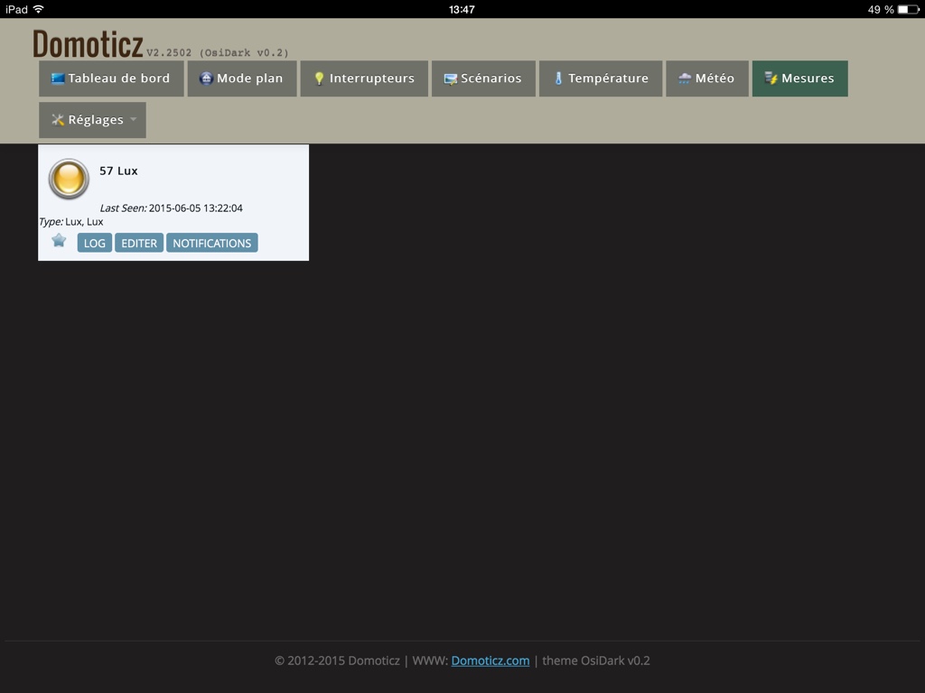

Hello, thanks for this theme.
I have a problem with an iPad in landscape mode, I don't see the top of elements because menus are on two lines
Thank you

Re: OsiDark theme for smartphone, tablet and desktop [v0.3]
Post by osiris »
Fixed your overlapping problem in v0.3. Unfortunately to fix this the navbar stays on top of the screen i.e. while scrolling it does not stick to the top of your screen.

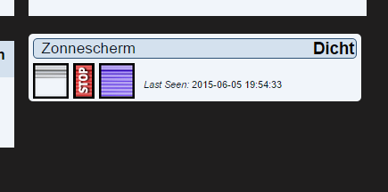

Nice theme! I found some issues doh,
Blinds don't display correct.

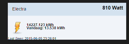

The tekst in the electra box issen't displaying correct.

@Timmit could you please post a screenshot of your problem with the electra box? The slider is not displaying correct because it has not been styled. See the first post for "know issues".

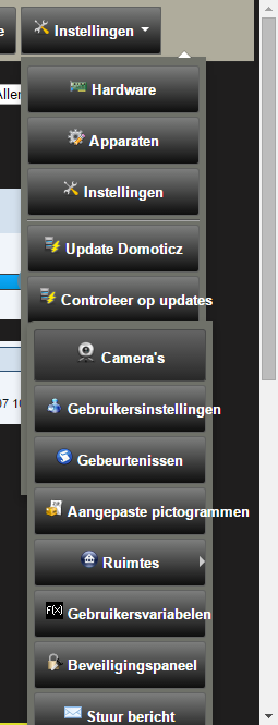

Also when i go to "setting -> more options" they display over the setting menu end not beside it. And long test won't fit in the textbox (example for me in dutch "gebruikersinstellingen")

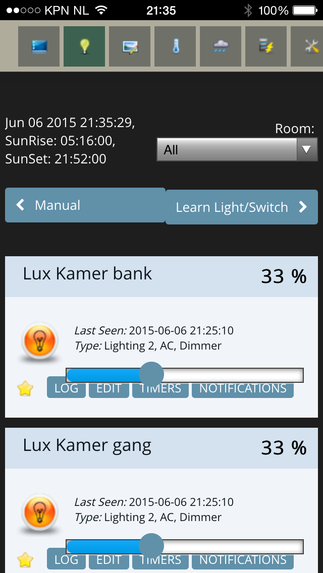

iPhone issues:
* doesn't fit on screen, you can scroll to the right, this seems to be cause by navbar
* dashboard: status of contact (in example below closed) is shown on button, which doesn't fit
* when opening Setup menu, you have to scroll to the right to see the menu. The menu is shown directly under the Setup button instead to the left of it
See the screenshots.

Post by osiris »
Thanks for the screenshots! On the emulator I can not reproduct your menu problem. This is what the menu looks like on the emulator:

The tekst in the electra box issen't displaying correct,
electra
electra
Blinds
Blinds
"setting -> more options" they display over the setting menu end not beside it. And long text won't fit in the textbox (example for me in dutch "gebruikersinstellingen")
settings
settings

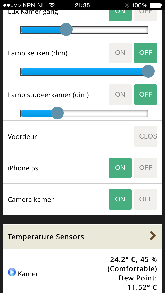

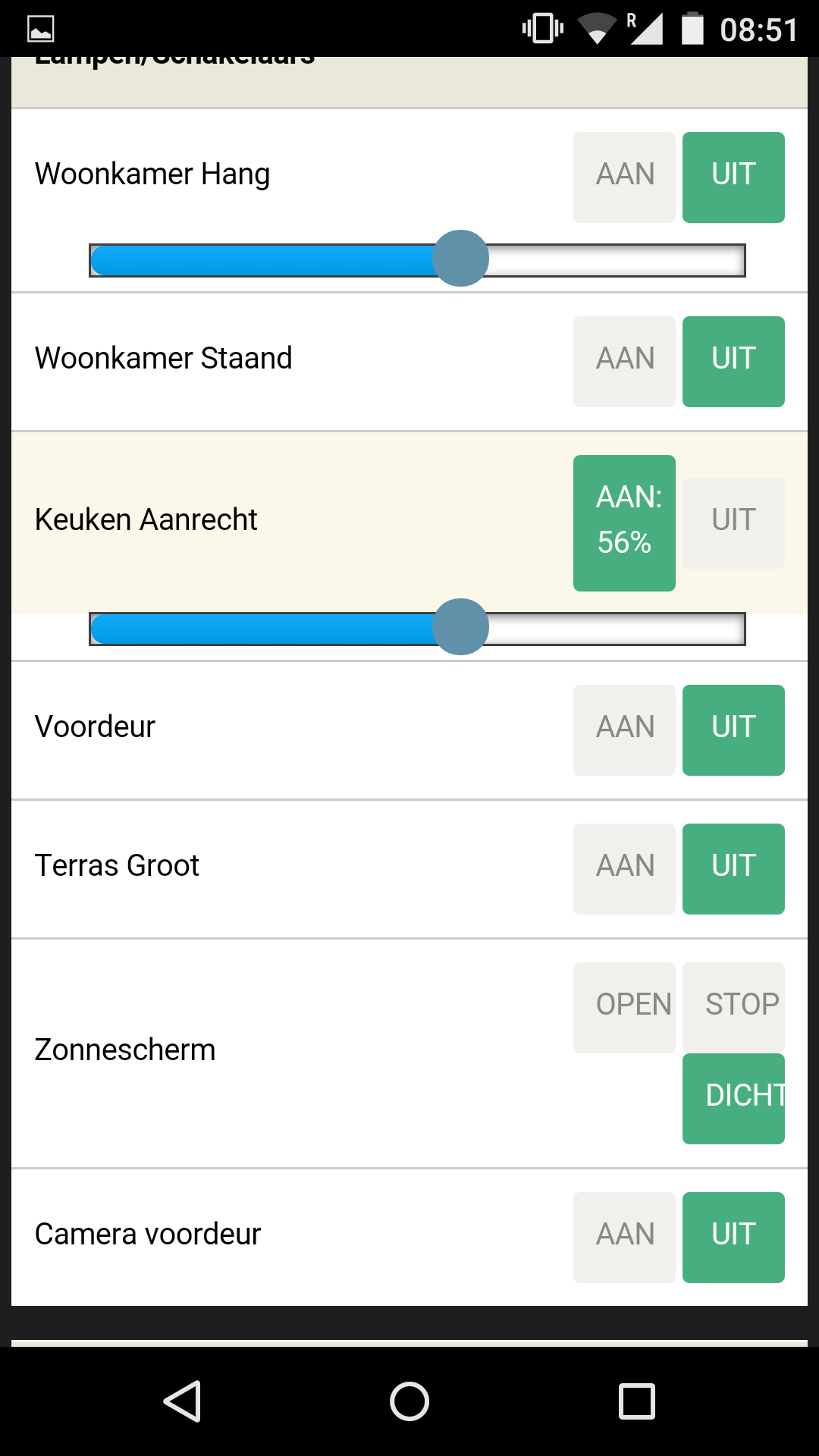

And some for chrome on android,
Same issue as G3rard posted,
G3rard wrote:iPhone issues:
srcoll
srcoll
buttons blinds and dimmer (%) don't fit on the dashbord.
blinds and dimmer
blinds and dimmer
