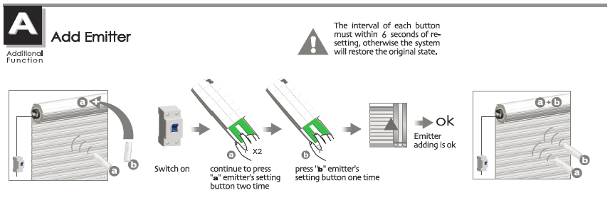

For other users who don't know how to put your Dooya motor in learning mode:
- disconnect power for at least 10 seconds
- connect power again and proceed with the pairing-procedure within 10 seconds
Pairing procedure:
- press confirm twice
- press UP once
Time delay between pressing the buttons should be below 6 seconds.

b_weijenberg wrote:Try this:
1 remove all remotes to be able to add the original remote as main remote
2 add the original Dooya remote as described in the Dooya user guide
3 press the pair button on the Dooya remote twice
4 transmit 1 confirm/pair command using RFXmngr to add the RFXtrx "remote"
Note: The ID can be anything except all zeroes and do not use unit code zero.
It worked, but i didn't follow steps 1 and 2. Just step 3 and for made it work for me.
Thank you very much! :)
