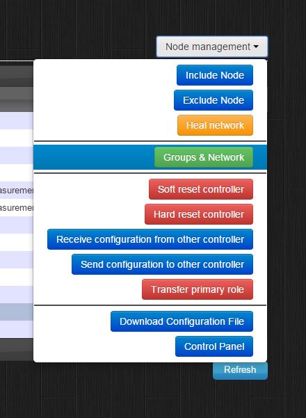

What I see in my situation:
Push Setup of the Z-stick.
Click Node management and select Groups & Network

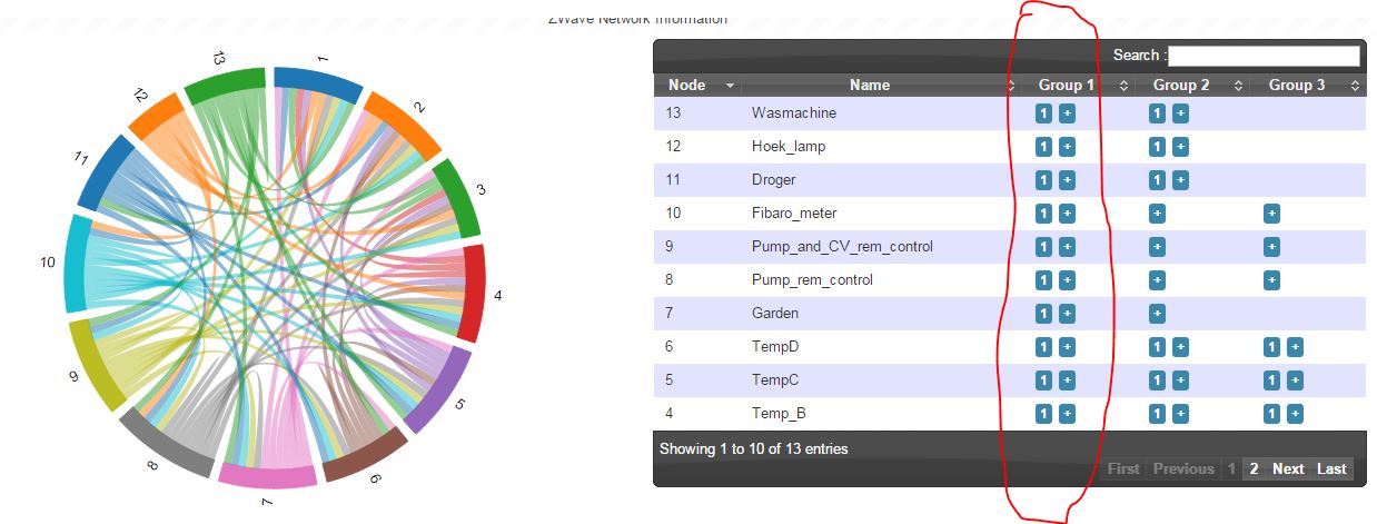

In Group1 all nodes report to the controller with id 1
Group 1 reporting to controller 1.JPG (90.44 KiB) Viewed 18394 times
If not available, push the plus sign and add number 1

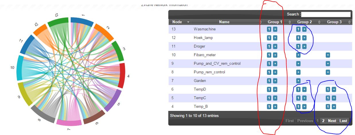

Group 2 and 3 can be used for secondary control with Key Fob or Remote Control (afaik)
Remove others.JPG (95.23 KiB) Viewed 18394 times
The blue marked Group 2 and 3 assignments are in my case currently useless, and can be removed by clicking the number 1.
After F5, they are updated.
Hope this helps,

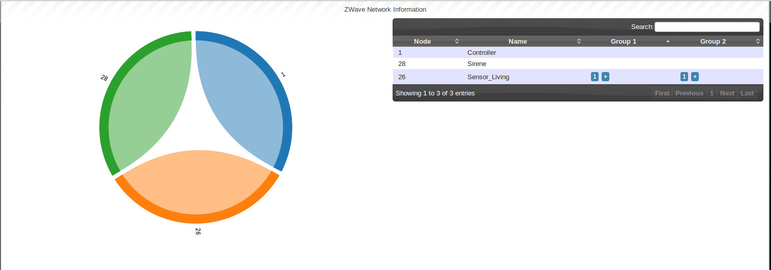

In my case, I have :
1 controller node 1
1 node 26 (philio multi sensor)
1 node 28 (siren)
Only node 26 appears like on your screenshot ( in column 'group1', the value '1' and a '+' sign
But for controller and node 28, nothing in line ( no '1', nor '+' sign : blank line !)
How to add something to node 28, if '+' sign is'nt displayed ?

I have clicked on hardware, then the setup button for the ZWave device. Then I clicked on the Network management button and then the 'Groups and Network' button in the menu that appears.
I then get the same inter node diagram that you have, with a table beside it. The Table though only has the node number and the name in the headings with no group information. I am using the raspberry pi version of domoticz vers 2.382 . There is clearly something I am missing here!
