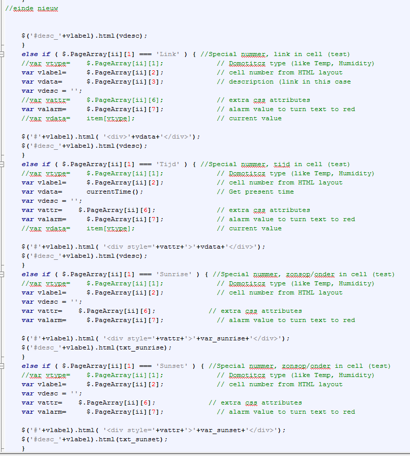

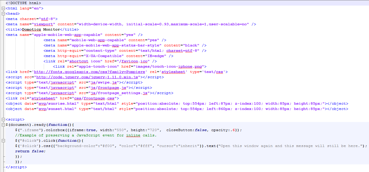

Here is wher i pit the code for the sunrise and sunset,
frontpage js.PNG (63.4 KiB) Viewed 6437 times
frontpage html.PNG (52.35 KiB) Viewed 6437 times

Edit : I just remembered something ...
I had some problems in the beginning with vdimmercurrent, so i loaded the vdimmercurrent into vdimmerc.
Maybe you have not filled vdimmerc causing the code to stop and break the function by this. Remember by the swipe module the "Strict mode" is set, so all variable should be declared and filled somehow before using them ....
I did it by this earlier in the code :
for( var ii = 0, len = $.PageArray.length; ii < len; ii++ ) {
if( $.PageArray[ii][0] === item.idx ) { // Domoticz idx number
var vtype= $.PageArray[ii][1]; // Domotitcz type (like Temp, Humidity)
var vlabel= $.PageArray[ii][2]; // cell number from HTML layout
var vdesc= $.PageArray[ii][3]; // description
var lastseen= $.PageArray[ii][4]; // Display lastseen or noT
var vplusmin= $.PageArray[ii][5]; // minplus buttons, or icon on
var vattr= $.PageArray[ii][6]; // extra css attributes
var valarm= $.PageArray[ii][7]; // alarm value to turn text to red
var vdata= item[vtype]; // current value
var vstatus= item["Status"];
var vls= item["LastUpdate"]; // ´Last Seen´
var vdimmercurrent= item["LevelInt"]; // What is the dim level
var Vdimmerc = vdimmercurrent; // something strangs happens along, so recreate new var
For me with KAKU it works like a charm :)
Complete FrontPage code : http://www.filedropper.com/frontpagesm = only temp download for 30days
Many personal tweaks done, mainly intiated in FrontPage settings file.
Please consider it as a fork, many things are changed by me for my personal use and code may not be 100% usefull or functional depending on your situation.
Most of it is commented in the code.
For example :
- i have created an option to make a cell protected via the settings file for cells that are not protected in domoticz itself.
- i have changed the dimmer function not to use 33 66 etc but back to 1-16 as this works more reliable on my kaku dimmers. I have currently only kaku installed in my
home.
- When the alarmtimer is triggere background changes to orange. (timer is started for 20 secs after a door is openend to be able to disarm,
With lua the disarm is done by ping my Phone to discover i am home :) and alarm is set armed away as soon as my Phone is not at home anymore)
- When alarm is triggered then background changes to red. (= alarm timer is finished and alarm is not disarmed) My smoke detectors will make sound on this.
- When the alarm is triggered a beep wil be played to get notified.
- When abroad ip is detected (VPN) then the FrontPage.html is switched to FrontPage_sm.html with less cameras and lower refresh to reduce bandwith
and many more...
For me all is 100% functional and no bugs so far , my only improvement next will be humidity and temp in shared cell to free up some space for future use.

btw : i went for the <div> solution and made temp on top and humidity below, but in a way you still can choose to work as initial designed by using the settings file.
when finished i will post the code :
FrontPage.html one cell example
<div id="cell1">
<div id="cell1A" style="height: 30%; float:top">--</div>
<div id="cell1B" style="height: 10%; float:bottem">--</div>
</div>
<div id="desc_cell1">cell1</div>
I did the above change for all cells exept camera cells
FrontPage_settings.js example, as you can see both divided cells and normal cells work together :)
['0','Desc',    	    'cell2',                        'Buiten (&deg;C/%)','0','0'],    // description when the split cell is used.
['68','Temp',           'cell2A',                       'BuitenTemp (&deg;C)','0','0','color:#FFCC66;font-size:90%'],
['68','Humidity',       'cell2B',                       'Vocht (%)','0','0','color:#66cccc;font-size:50%'],
['150','CounterToday',  'cell4',                      	'Electra vandaag (kWH)<br />','2','0','color:#99ff33;font-size:100%'],
FrontPage.js adjustment just to get a description when the cell is split.
else if ( $.PageArray[ii][1] === 'Desc' ) { //Special nummer, IP in cell (test)
  	     //$('#'+vlabel).html( '<div style='+vattr+'>'+vdata+'</div>');
             $('#desc_'+vlabel).html(vdesc);

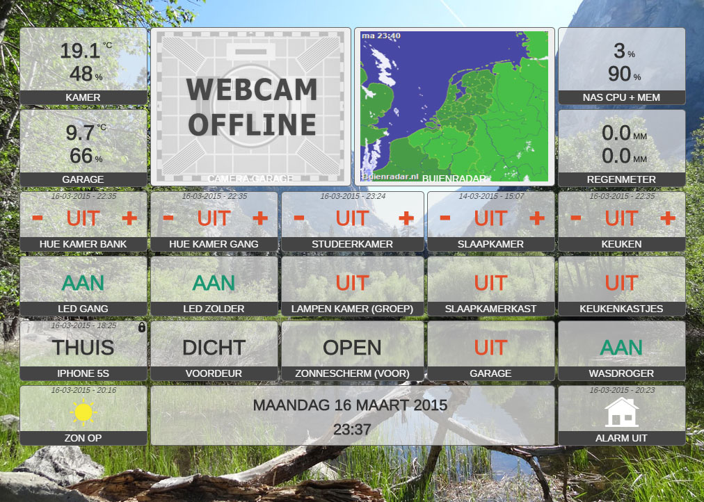

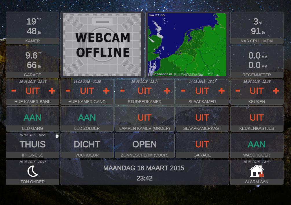

I have updated my frontpage.
I made among others the following changes:
- text with cell description changes according to the state (eg alarm on/off, sunrise/set)
- removed bounce effect (no vertical scrolling) on iPad
- use extra div's in the cells above (see also the post from zicht)
- various layout changes
I still want to add the possibility to operate the blinds (any suggestions are welcome).
I will share the files after I have done some checks and cleanup of the code.
Not using Domoticz anymore
