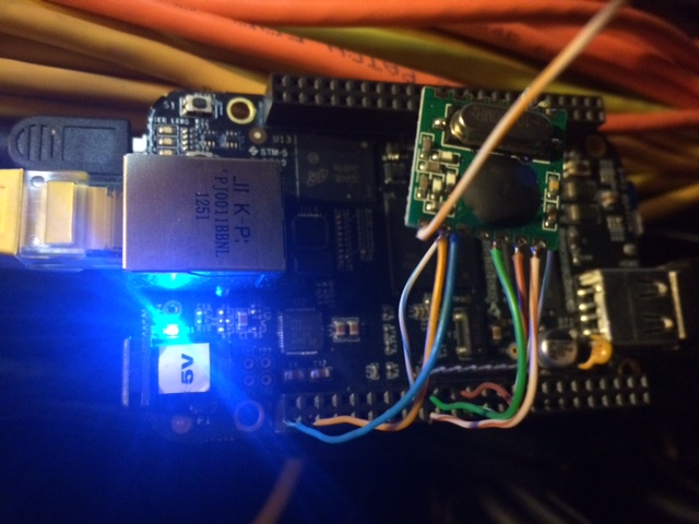

Is there anyone working on the Open Energy Monitor? I ordered this energy monitor V3 with 4 CTs. I want to make my own driver for the RFM12b so that I dont need to interface with the RFM12Pi which looks like an extra step to me. Why can't a 600 Mhz 32 bit processor (Or 1000 Mhz Beagle Bone Black) take on a job of a 8 Mhz 8 bit MPU? Anyway all I want to know if anyone is interrested in helping me. I looked into other Energy Meters but they are all 1 phase or 3 phased based and here in Canada residential we have 2 phase 120V also the Open Energy Monitor is nicely priced compared to commercial versions..
Cheers Rene,
Cheers Rene,
- RF12 module strapped to Beagle Bone Black
- image1(1).JPG (97.78 KiB) Viewed 11990 times

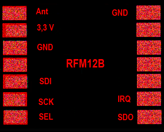

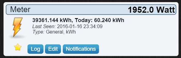

Ok I got a bit futher with this. I created a Python Scripts that will read the data directly from a RFM12B chip into my BeagleBoneBlack. I am not using the nIRQ line from the chip but use polling which makes the BBB very busy. But it does give me data so I am very pleased. The origional project uses a RaspberryPi board with its on ATMEGA Micro Chip on board.
Steps to get this to work.
1. Make connections between RFM12B and your processor board (In my case BeagleBoneBlack)
2. install spidev
3. install requests
4. enable spi interface (this requires some steps on the BeagleBoneBlack)
5. create 4 energy meters in Domoticz and fill in their IDX values in the script.
6. Execute by python <script>.py &
2. install spidev
3. install requests

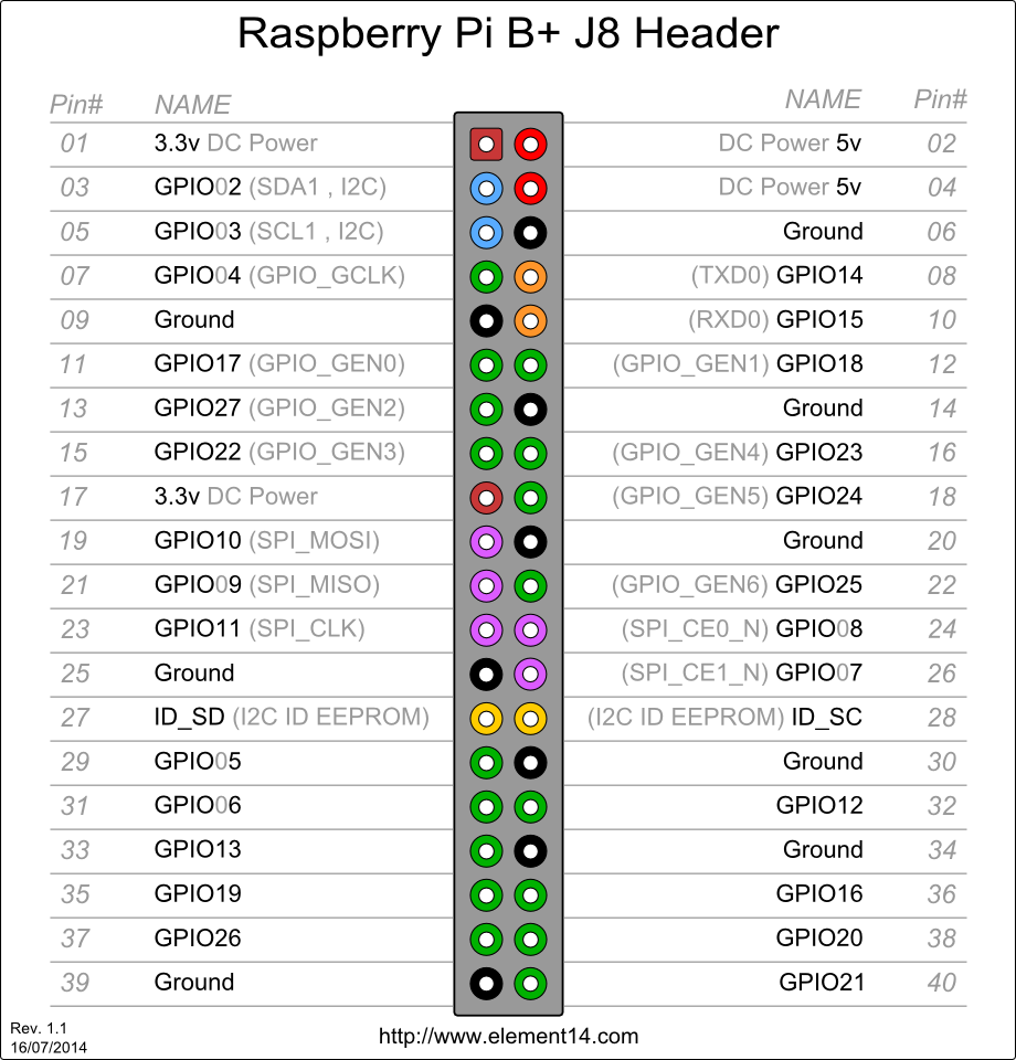

I have setup a Raspberry pi B+ with latest domoticz image.
Raspberry Pi Details:
Type: Model B+, Revision: 1.2, Memory: 512MB
ls /dev/spidev*
/dev/spidev0.0 /dev/spidev0.1
minicom -b9600 -D/dev/ttyAMA0
Current configuration:
64 i0 g2 @ 433 MHz Lock: 1
Test working!
rpi-serial-console disable
changed spi.open(2,0) to spi.open(0,0)
Changed IDX and electric current to 230V
CR=1
Running sudo python yourscript.py
And it,s running but nothing happened.
You must break with ctrl-c, ´can you run it with debug-mode ?
Thank You!

Couple of things you can do. Put a print data line just above if crc == 0 line. This will print a line with the received data. If your reception is good you will see a pattern. The other thing you can do is to install spi-test just google how to do that. You should see some data come by. If you only see ffs your spi interface doesnt see the rfm 12 module make sure you have the right spi port. Also open(0,0) is spi port 0 with cs0 active so maybe you used cs1 on the Pi in that case use open (0,1). The code is for the RFM12 module not for the RFM69 Ok. Let me know if this helps you along..I do not see a reason why it would not work on the Raspberry Pi.cosmo61 wrote:Hi!

In The Py program u use SPI connection. If I understand this correct, you have to connect RFM12Pi V2 to (3.3v) pin 17 and etc?
RFM12B !! not RFM12Pi V2 (serial interface), my mistake!
would the Raspberry Pi connection to RFM12B be something like this?
Is it okej to use GPIO_22 ?
corrected
CE0 -> nSEL
GND -> GND
SCLK -> SCK
MISO -> SDO
MOSI -> SDI
3,3V -> VCC
#GPIO_22 -> IRQ
PIN 15, 17,19,21,23,25
see the attachments!
- RFM12.png (49.78 KiB) Viewed 11488 times
- rpi pin.png (192.03 KiB) Viewed 11598 times

Ok update so far, hooked up RFM12B chip to Raspberry Pi. You are missing the Chip Enable 0 line in your diagram! It needs to be hooked up to pin 24. And the MOSI does go to SDI on the RFM12B module. Ok, so far this works but then the trouble starts. If I do a print data I get a couple of bytes fine [10,12,] but then it messes up. It looks like the Pi can't keep up with the data (which comes in at 44 kbit), my Beagle Bone Black had no issues. Not sure yet how to fix this speed problem, working on it right now. I might have to convert the program to a C version. I will keep you posted.
Rene

Re: Open Energy Monitor
I have the total kwt counter working fine with arduino + pulse count + MySensorsdwmw2 wrote:
I haven't quite worked out what sensor types to use with Domoticz though. I can't see a sensor type which has only a power value in Watts; only one which also has a counter. And the although I do also have the pulse counter, the Domoticz sensor for that doesn't work correctly when the unit restarts and the pulse counter resets.
- Screenshot (17).png (33.63 KiB) Viewed 9638 times
