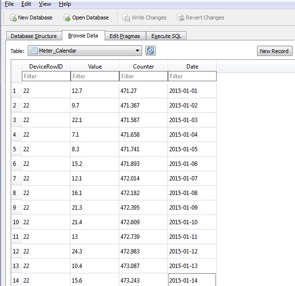

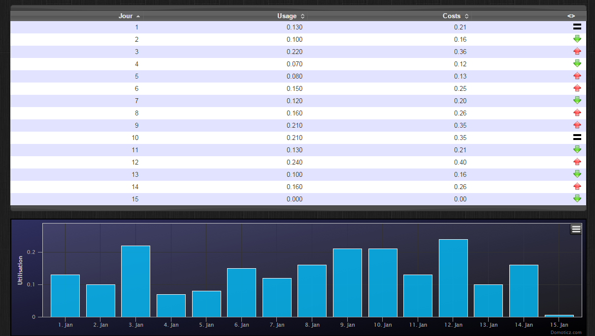

So after a lot of test I finaly get the good setup.
I will paste here is it could help :
sqlquery look like this :
INSERT INTO `Meter_Calendar` VALUES ('ID of the device','consuption of the day','counter value','day');
INSERT INTO `Meter_Calendar` VALUES ('22','12.7','471.27','2015-01-01');
INSERT INTO `Meter_Calendar` VALUES ('22','9.7','471.367','2015-01-02');
INSERT INTO `Meter_Calendar` VALUES ('22','22.1','471.587','2015-01-03');
INSERT INTO `Meter_Calendar` VALUES ('22','7.1','471.658','2015-01-04');
INSERT INTO `Meter_Calendar` VALUES ('22','8.3','471.741','2015-01-05');
INSERT INTO `Meter_Calendar` VALUES ('22','15.2','471.893','2015-01-06');
INSERT INTO `Meter_Calendar` VALUES ('22','12.1','472.014','2015-01-07');
INSERT INTO `Meter_Calendar` VALUES ('22','16.1','472.182','2015-01-08');
INSERT INTO `Meter_Calendar` VALUES ('22','21.3','472.395','2015-01-09');
INSERT INTO `Meter_Calendar` VALUES ('22','21.4','472.609','2015-01-10');
INSERT INTO `Meter_Calendar` VALUES ('22','13','472.739','2015-01-11');
INSERT INTO `Meter_Calendar` VALUES ('22','24.3','472.983','2015-01-12');
INSERT INTO `Meter_Calendar` VALUES ('22','10.4','473.087','2015-01-13');
INSERT INTO `Meter_Calendar` VALUES ('22','15.6','473.243','2015-01-14');
Hope it will help
Anyway thanks Jan_nl
Some pict from domoticz and sqlite

I see 2 possibility to solve your issue here :
- both value and counter column have to be filled with the appropriate data. ValueN= CounterN - Counter N-1 (be carefull on the unit, compare with my value bellow)
- In my case I have one row / day. Try to fill all days between first and last day.
Let me knwo if it help.
Br,
Br,

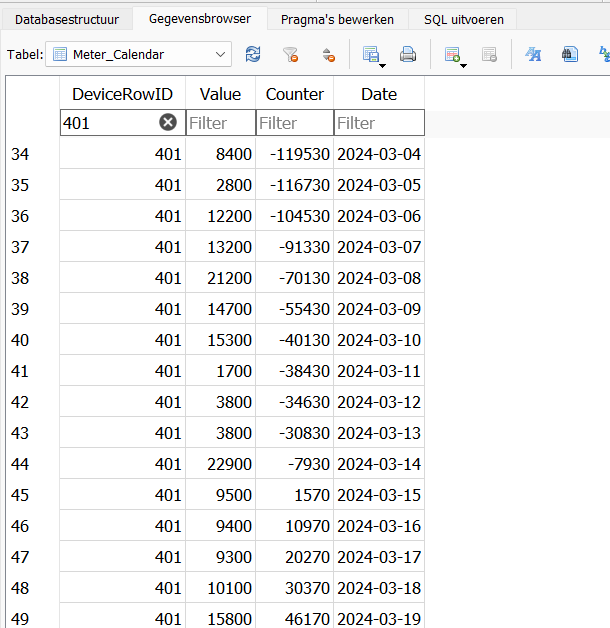

A week ago, I installed the Eastron SDM120-Modbus kWh meter to measure the solar energy produced by my solar panels and my Growatt inverter. Although it is possible to read the Growatt energy production directly, I was not satisfied with the stability of the connection with Domoticz. Currently, I'm facing the following issue:
I have transferred the history of my solar energy to the Domoticz database. However, I have mixed feelings about the result. I can see the following historical information on the screens for:
By the way, I made the following modifications to the "Meter_Calendar" table:
I added my solar information only to the meter_calendar table.
The calculated counter values needs to be negative because the Eastron kWh meter starts at 0 kWh. So, I have to count back from this value, resulting in negative counter values.
I’m looking forward to receiving your support.
- Usage last week
- Usage last month
- Usage last year

The compare graph uses the same values from the Meter_Calendar table. But it needs both a running counter and the delta.
What data did you send to the table?

Yes, both the delta's and counters are added to the table (otherwise you could not see any history informtion).
Here are some screendumps:
Database: screendump of the graphs: As you can see no information is shown of the month februari.

It could be the negative counter values are not supported by the compare graph....

Yeh, a negative counter is not accepted. The problem is solved after I changed the negative values into positive values.
