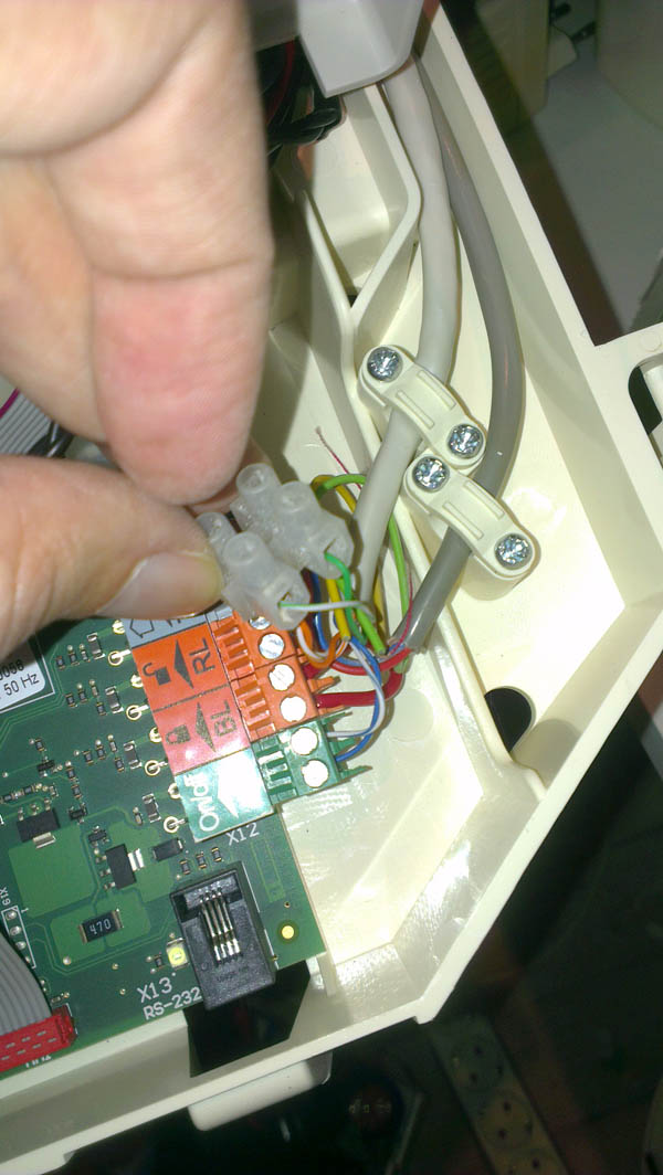

@pwhooftman kan you take a picture of your calenta please how to connected the wires from the Calenta to the OTGW en from the OTGW to the thermostat please. Because i just went to see my setup upstairs en there are 5 or 6 cables in a tube coming fromthe wall straight into my calenta so ican't picture how the OTGW gets to be in the middle (especially when i never sodlered anything in my life)

Hi Deske,
My iSense is connected to the boiler with 2 wires.
I just cut that wire near the boiler, put the cable with 2 wires coming from the iSense to connector X1 , and the cable with 2 wires going to the boiler on connector X2:
Good chance that your 5-6 cables in the tube are a) not all connected to the iSense (detach it from the wall and take a look) or b) go to other stuff like outdoor temperature sensor of extra (floorheating) waterpump.

@pwhooftman very clear info ! Thanks man. As soon as i have the guts to pay the 90 EUR for the otgw ill let you know here.

Is it not easier to
* open the door of the Calenta unscrew the wires of the green connector
* Add an extra cable with at least 4 wires (UTP cable will work)
* Screw 2 wires on the green connector (blue and white-blue in the picture)
* Connect (with a screw terminal for example) the 2 disconnected wires to 2 other wires of the new added cable (green and white green in the picture)
* Now add the other end of the 4 wires to the OTGW (blue and white-blue to boiler and green and white green to the thermostat)

Image doesn't work and post edit is not available after a few seconds....
- Connect OTGW to boiler.jpg (112.35 KiB) Viewed 10524 times

You mean
- detach the two wires from the green terminal in the calenta
- add extra length to that two wires and lead them out of the Calenta to the OTGW thermostat terminal
- lead two wires from the OTGW boiler terminal back into the Calenta to the green terminal.
Sure, also possible. Whatever suits you.

Yes, thats what i meant.pwhooftman wrote:You mean
