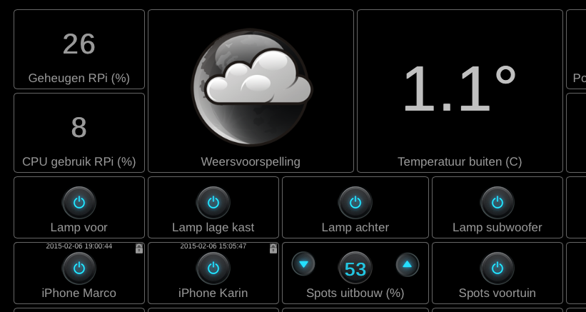

I managed to get it to work with the 'IsNight'.
I've put the
var Isnight = 'yes'; in the frontpage_settings.js
And in the frontpage.js I added something like:
   if (vdata == 'Partly Cloudy' & IsNight == 'No') {
   vdata=new String(vdata).replace( "Partly Cloudy","<img src=icons/04day-partlycloudy.png width=204 height=204>");
etc.
The IsNight is set in the part where I let the .css be chosen, based on the IsDonker var :)
	if(item.idx == idx_IsDonker && vdata == 'Off'){
	document.getElementById('dark-styles').disabled  = true;				// day
	IsNight = 'No';
	if(item.idx == idx_IsDonker && vdata == 'On'){
	document.getElementById('dark-styles').disabled  = false;				// night
	IsNight = 'Yes';
So far so good. Now, lets see what the forecast image does when the sun sets :)
Edit: OK, maybe it's not the way it should / could be coded, but hey.....it works. If someone could rewrite this, be my guest :)

jannl
Posts: 875
Domoticz version: 2026.1.x
Location: Geleen
Post by jannl »
Should work like this.
Basically the same I did. IsDark can not be used, I my case IsDark contains an idx value.
mvveelen
Posts: 721
Post by mvveelen »
It does work like this, but I meant that the code could be rewritten somehow.
It's after sunset, and this is the way the forecast is now:
Schermafbeelding 2015-02-06 om 20.13.13.png (97.88 KiB) Viewed 4229 times

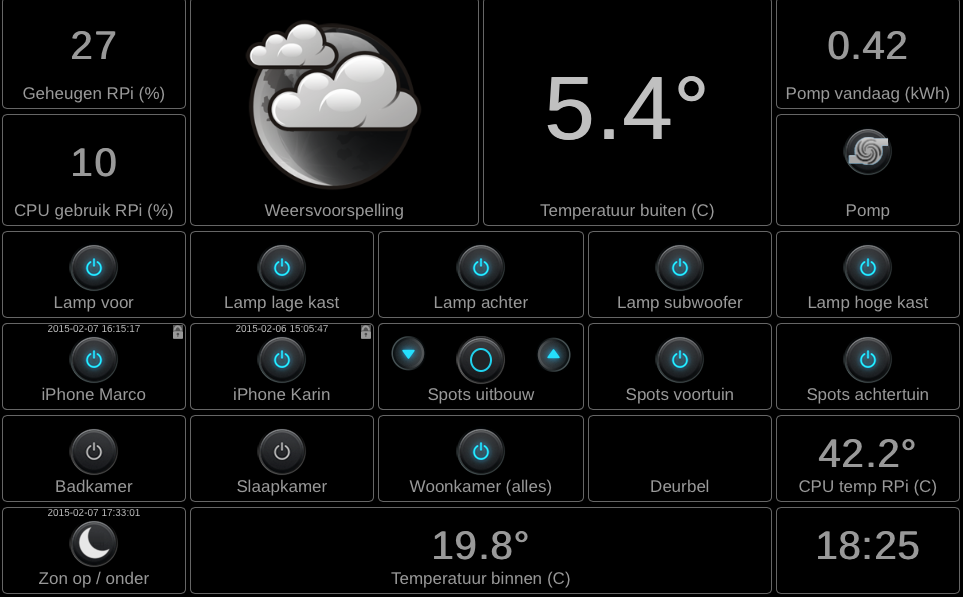

Just made some layout-tweaks:
- The sun / moon are now displayed on a similar button as all the others
- The % (text) for the dimmer isn't displayed anymore. instead there is a blue circle that becomes smaller or bigger when you dim the light.
I only have one problem with this last one: I can't use the button to switch the dimmed lights off. I made the numbers (%) 0% so it isn't displayed, that's why I can't use it to click on. When I use opacity to let the text to be transparent (and let it be big enough to make it clickable), both up and down buttons will be transparent too and that's not what we want do we :) ?
If anyone has a quick fix for this....??
