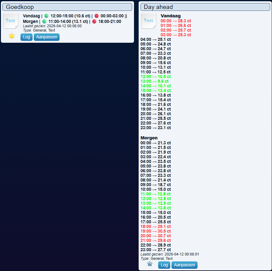

I'm trying to make a DZvent script which read the user variable Enever_Electricity_33 and Enever_Electricity_tomorrow_33
The goal is to trigger a switch which is active in the cheap hours and show a table white cheap hours and expensive hours.
It looks like this:
The script is running every 1 min because it also need to set a switch is the cheap hours.
The script only refresh correct after a Domoticz restart without a restart it looks like DZvent is using cached values.
So without a restart of Domoticz my table stay the same for days.
