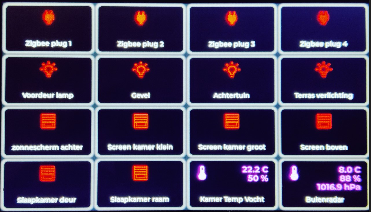

I have a switch named "Terras verlichting". It is not an On/Off switch but a dimmer. How can i change the icon op the display so i can also set a value or slider?
- Display_dash.jpg (181.13 KiB) Viewed 12751 times

Re: New project, a small wall display to control Domoticz using CYD (Cheap ESP32 touchscreen)
@Rik60
So ATM the device is reconised as simple light, without dimmer feature ?
Can you give me some information about the device ?
The code set a Dimmer if
- type = "Light/Switch"
- subtype = "Switch"
- switchtype = "Dimmer"
You can see thoses information on the device widget in domoticz or using a browser
http://IP:PORT/json.htm?type=command¶m=getdevices&rid=ID-

Ok so I think you have found the problermIf i switch the lamp off, data is " Off", if the lamp is on at a level, data is "Set level: 46%".
On device_panel.cpp around line 409, replace
if (strcmp(SelectedDevice->data, "On") == 0)Code: Select all
if (strcmp(SelectedDevice->data, "Off") != 0)Code: Select all
if (d->type < TYPE_SWITCH && strcmp(d->data, "On") == 0)Code: Select all
if (d->type < TYPE_SWITCH && strcmp(d->data, "Off") != 0)-

Yes, it's working now. Slider is ok, and on the display's dashboard the lamp is "On" when the lamp is switched on.
Just a thought, is it possible to have a push button as On/Off switch? Now it's a slider switch next to the level slider

Nice, the updated code is not yet online, but next versin will include your changes.
Ha yes, the defaut "button" is a switch (a little slider with 2 positions) not a button, but it's the defaut one, for device making only on/off it's possible to switch them direclty on home page, but as this one have slider too, you have the "switch".
But what is the problem with it ? It's just visual, it's not a slider, on press toggle the state, there is no mouvement to done. It's like a button with 2 states ?
is it possible to have a push button as On/Off switch? Now it's a slider switch next to the level sliderBut what is the problem with it ? It's just visual, it's not a slider, on press toggle the state, there is no mouvement to done. It's like a button with 2 states ?
Rik60
- Posts: 230
- Joined: Sunday 25 June 2023 21:54
- Domoticz version: 2026.3
You are right. I thought that it was a slider. If i press it, it's toggles.
Is it possible to have the switch on the same high (line) as the level slider? I think it looks nicer.
Thanks for all your work.

I can't make it general but it's fast.
In device_panel.cpp around line 499, replace
by
lv_obj_center(slider);Code: Select all
lv_obj_align(slider, LV_ALIGN_CENTER, 0, -19);-

I have changed:
into
I think it's nicer...
lv_obj_align(slider, LV_ALIGN_CENTER, 0, -31);
