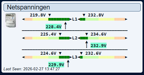

Because i also wanted to see what the mains-voltages was doing i made this dzVents-script a view jears ago that shows the voltages provided by the P1-port of my mains-meter:
-- Voltage Bargraph maker for text device -- RonkA
        timer = {'at 23:59'},
        devices = {27} -->-->-->- set correct idx number of P1_device
    data = {
        min_voltage_L1 = { initial = 229.9 }, -- Initialize the min_voltage_L1 variable; for 120v mains set to 119.9
        min_voltage_L2 = { initial = 229.9 }, -- Initialize the min_voltage_L2 variable; for 120v mains set to 119.9
        min_voltage_L3 = { initial = 229.9 }, -- Initialize the min_voltage_L3 variable; for 120v mains set to 119.9
        max_voltage_L1 = { initial = 230 }, -- Initialize the max_voltage_L1 variable; for 120v mains set to 120.1
        max_voltage_L2 = { initial = 230 }, -- Initialize the max_voltage_L2 variable; for 120v mains set to 120.1
        max_voltage_L3 = { initial = 230 }, -- Initialize the max_voltage_L3 variable; for 120v mains set to 120.1
--[[    logging = {
        level = domoticz.LOG_ERROR,
        marker = 'Bargraph',
-->-->-->- values are set for 230 volt mains with a 10% tolerance according to NEN-EN 50160
        -- for 120 volt mains with a 5% tolerance (ANSI standard) adjust values accordingly
-- domoticz.log('Bargraph - Net - Voltages ' .. device.name, domoticz.LOG_INFO)
        local padding = 7               -- number of invisible blocks to allign the 2nd and 3rd bargraph in the textdevice
        local bar_length = 17           -- number of segments in bargraph       - for 120 volts mains
        local low_value = 207           -- begin value of the low red zone      - 114
        local low_red_value = 212       -- value to start the low red zone      - 116
        local low_yellow_value = 220    -- value to start the low yellow zone   - 118
        local mid_value = 230           -- middle of green zone                 - 120
        local high_yellow_value = 240   -- value to start the high yellow zone  - 122
        local high_red_value = 248      -- value to start the high red zone     - 124
        local high_value = 253          -- end value of the high red zone       - 126
        -- fictional values if less than 3 phase are used.. do not remove!
        local voltageL2 = 231
        local voltageL3 = 231
-->-->-->- for 1 phase metering only use voltageL1; voltageL2 and voltageL3 have to be commented out! (set -- in front of local..)
        -- for 2 phase metering only use voltageL1 and voltageL2; voltageL3 has to be commented out!
        -- set correct idx number of voltage device(s)
        local voltageL1 = domoticz.utils.round(domoticz.devices(28).voltage,1)
        local voltageL2 = domoticz.utils.round(domoticz.devices(29).voltage,1)
        local voltageL3 = domoticz.utils.round(domoticz.devices(30).voltage,1)
-->-->-->- idx number of the textdevice; change accordingly
        local text_device = domoticz.devices(337)
        -- initialize min and max voltage values
        local voltageL1_min = domoticz.data.min_voltage_L1
        local voltageL2_min = domoticz.data.min_voltage_L2
        local voltageL3_min = domoticz.data.min_voltage_L3
        local voltageL1_max = domoticz.data.max_voltage_L1
        local voltageL2_max = domoticz.data.max_voltage_L2
        local voltageL3_max = domoticz.data.max_voltage_L3
        -- store value when voltage is lower or higer than the stored min or max voltage
        if voltageL1 < mid_value and voltageL1 < voltageL1_min then
            domoticz.data.min_voltage_L1 = voltageL1
        if voltageL2 < mid_value and voltageL2 < voltageL2_min then
            domoticz.data.min_voltage_L2 = voltageL2
        if voltageL3 < mid_value and voltageL3 < voltageL3_min then
            domoticz.data.min_voltage_L3 = voltageL3
        if voltageL1 > mid_value and voltageL1 > voltageL1_max then
            domoticz.data.max_voltage_L1 = voltageL1
        if voltageL2 > mid_value and voltageL2 > voltageL2_max then
            domoticz.data.max_voltage_L2 = voltageL2
        if voltageL3 > mid_value and voltageL3 > voltageL3_max then
            domoticz.data.max_voltage_L3 = voltageL3
        -- check if it's nighttime (23:59) to reset bargraph variables
        if (device.isTimer) then
            domoticz.log('Reset Bargraph Voltage Variables', domoticz.LOG_INFO)
            domoticz.data.min_voltage_L1 = 229.9
            domoticz.data.min_voltage_L2 = 229.9
            domoticz.data.min_voltage_L3 = 229.9
            domoticz.data.max_voltage_L1 = 230
            domoticz.data.max_voltage_L2 = 230
            domoticz.data.max_voltage_L3 = 230
	        return

Basically the trigger is done by the P1 device and once triggered the values of the voltage devices are read and sent to a text-device, the log of the text-device is cleared at the end of the script.
You have to create a text-device set all the correct IDX numbers! (6 times total..)
On top of a bar are the lowest and highest voltages shown, these numbers are reset at midnight.
The value under the bar is the current voltage for the phase..
The script can also be altered to show 1 or 2 phase voltage supply's and set to work with 120 volt as stated in the comments in the script.(this i did not test this too thoroughly tho..)
I use a chrome browser to display my Domoticz and at my end this works great, on mobile devices the view is distorted a bit, also there could be problems if the font Consolas is not present on your setup, for this reason i did not post this earlier..
See also viewtopic.php?t=42390 and viewtopic.php?t=42360 for similar projects..
